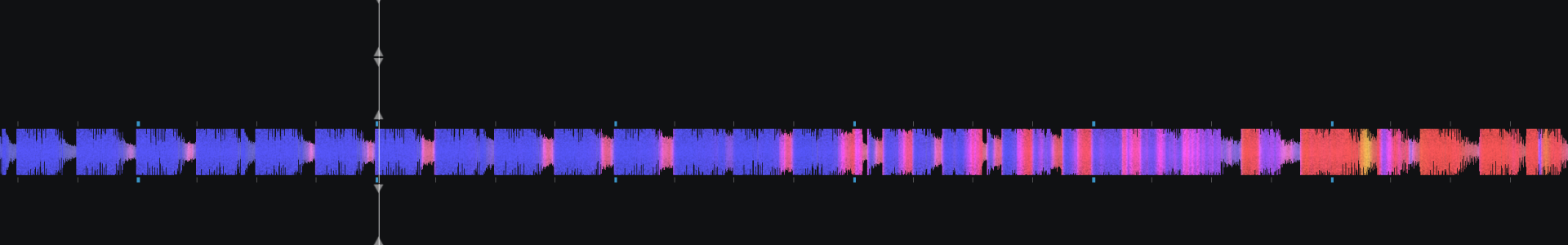

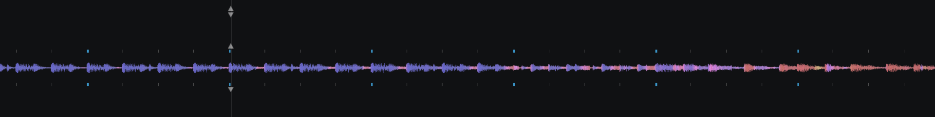

thx djdad for your kind response
See the photos i attached, is shows the exact issue i mean

Posting.2 images doesn’t really help.
What exactly are we looking at and what did you change to get the difference?

That's gain change not eq, and is hardcoded - can't be changed.
Posted Fri 17 Apr 26 @ 3:03 pm

So I can't stop the waveform from doing that, as sometimes when i increase it, it shows full and can't see the downbeat when mixing
Posted Fri 17 Apr 26 @ 5:21 pm
No. And it's on purpose. So that when you increase gain, you see what you're doing at your audio and how you compress everything and bring it close to distortion.
Generally speaking, you need to set the zerodb setting correctly so that you RARELY have to use the gain knobs (with autogian enabled of course)
Posted Fri 17 Apr 26 @ 5:45 pm
