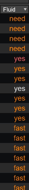

Maybe the info you are looking for is in the browser, "Fluid" column.
It shows if Fluid is suggested = need
If the track has new Fluid CBG = yes
if previous/old Mulit-BPM CBG = fast
or if Rigid CBG = nothing (blank)
note: the column can be reduced to 1 character wide, '
to show: n, y, f or nothing
and not use precious browser realestate.
And YES both the fast and yes type of CBGs have the tilde, in the BPM column.
