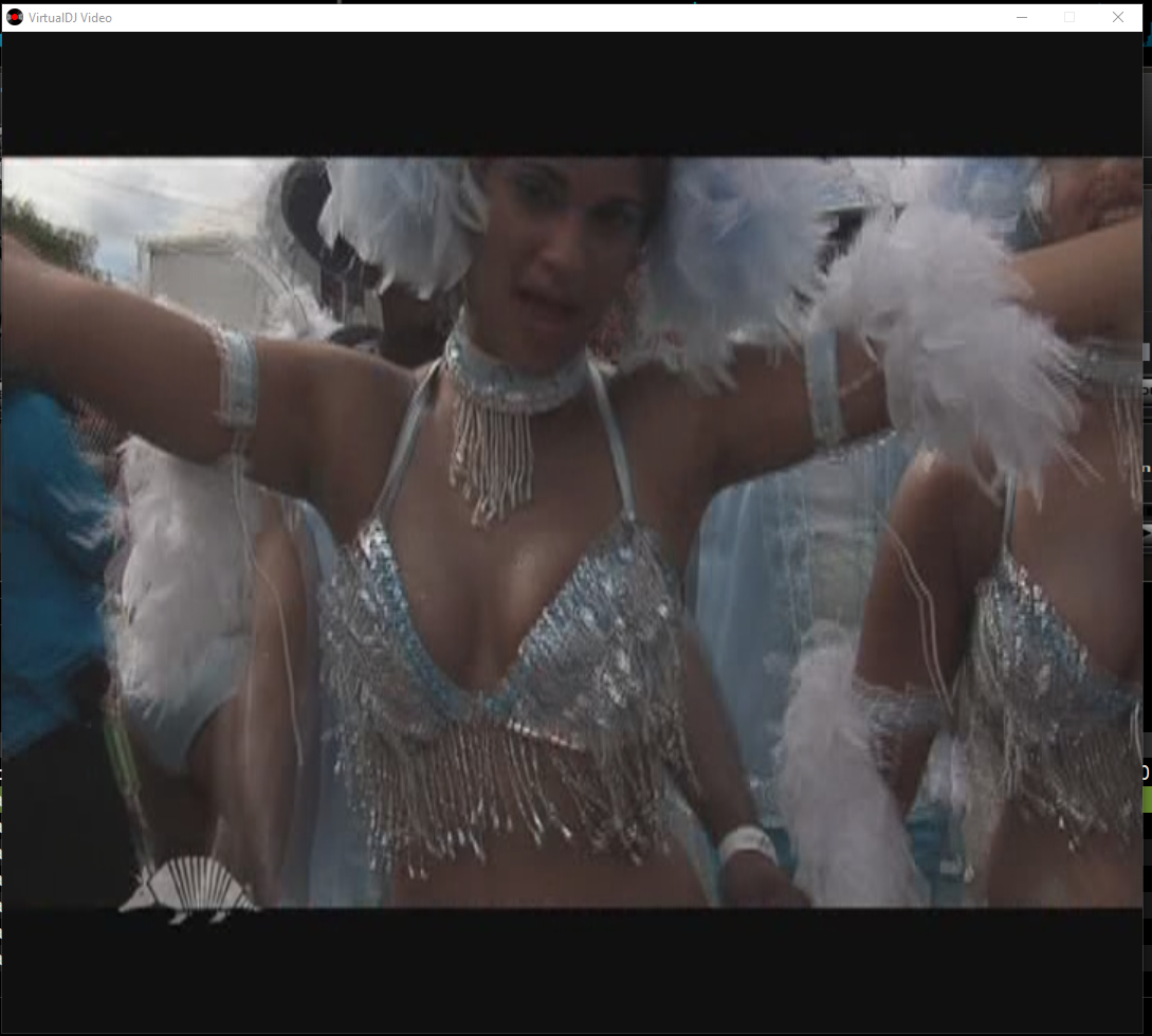

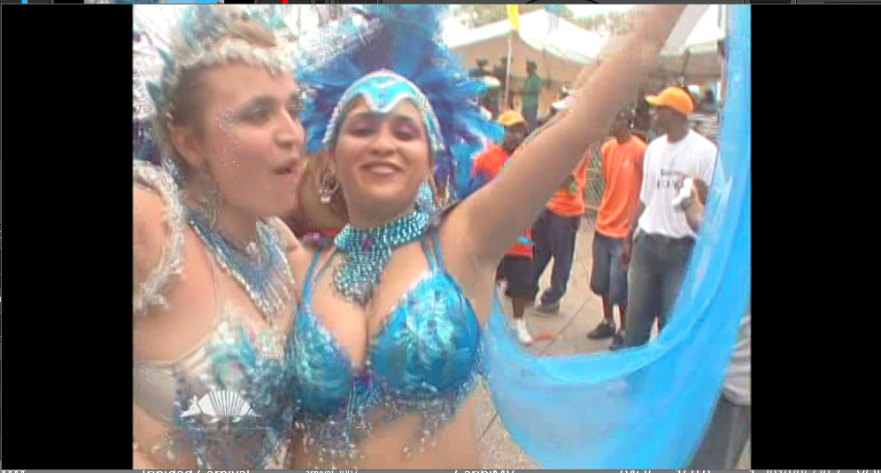

How can I fix this problem, some video's display full screen and some does not, included sample image.

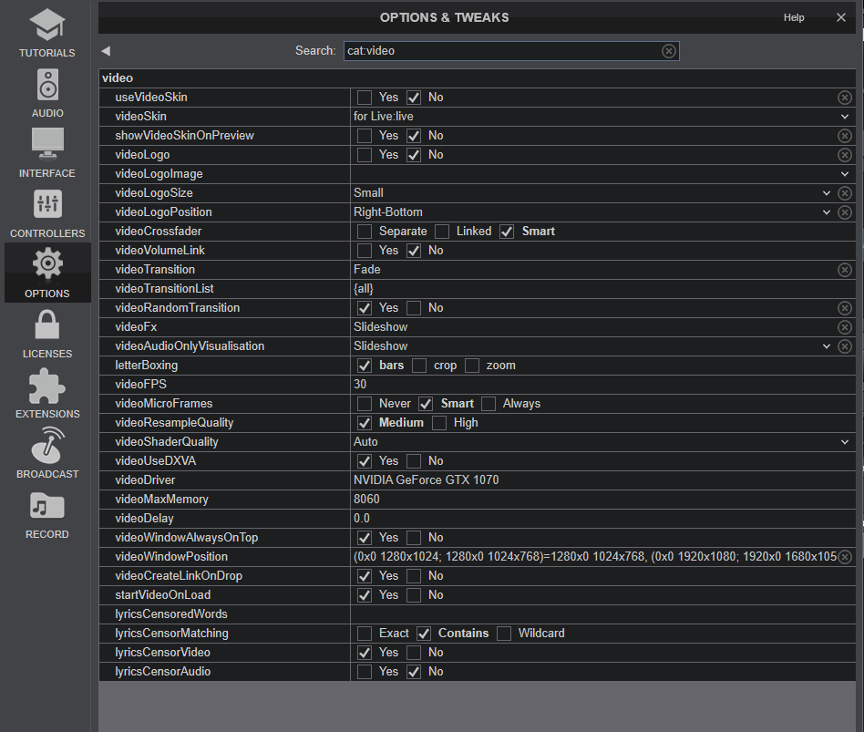

setting letterBoxing
but it's a bit of a muddled fix [and always will be], some vids will look ok zoomed, others ok when cropped, bars the image will always look right you could fill the edges with blur plugin.

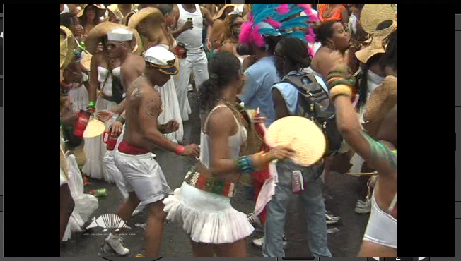

The question is whether it's encoded as an actual 4:3 video or it's 16:9 with the 4:3 window inside it.
If it's the latter, the black bars are part of the video.
Posted 22 hours ago
If the black bars are permanently there on a 4:3 video you can use Handbrake to easily remove them.
