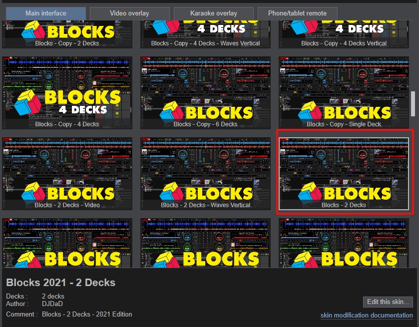

I'm asking you to use the default skin to do this task because I'm not sure if the skin you're using supports pad page assignment or not. From your screenshot I can see that you use a custom skin, but I can't tell which one.

The skin I was use Blocks - 2 Decks

I test with skins :: Default - Performance , Default - Pro , Default - Essentials , Default - Starter
