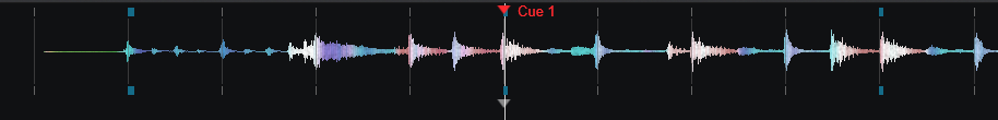

Niels (cph) wrote :
... I am playing around with Diana Ross Upside Down, and it gets the first downbeat wrong. This is perhaps to be expected, but I can’t figure out how to override it and set 1.1 explicitly.
The track starts with 2 beats of percussive guitar strumming before the band falls in at what should be 1.1.
Isnt the Cue 1 position in my image the "downbeat" ?
If you follow the Track, the 1st beat of each bar is where you usually hear the drum+snare

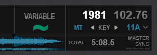

Update to my earlier post about the tiny tilde and padlock:
Initially I put VARIABLE text under the BPM of each deck, which was fine on my big 32" screen, but when I updated my laptop it became clear that it was too small for that screen size, so...
Now it's in the BPM editing area (which I never used) with a big green squiggle and large text.
Posted Mon 23 Feb 26 @ 3:26 pm
No, the first beat of first bar (1.1) is 2 beats before your cue point.
