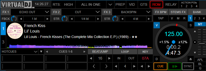

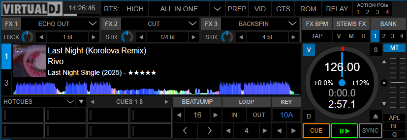

I made a thing!

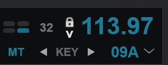

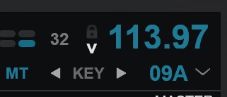

Rather than having the tiny little squiggle (for variable tracks) with the lock above it, I put the word VARIABLE below the BPM, and clicking it locks the tempo & changes the text to LOCKED.
Yeah.. I updated my skin as well
Normal track:
Variable BPM track:
Stabilized track:
Posted 3 hours ago
It was seeing your skin this morning and looking at how you did it, that made me think to add the text. 👍
I think maybe some people will find the tilde a bit too small. I did try making it larger, and also making it bright green so it's more visible. The best thing with VDJ is being able to "Frank Sinatra" (do it our way).

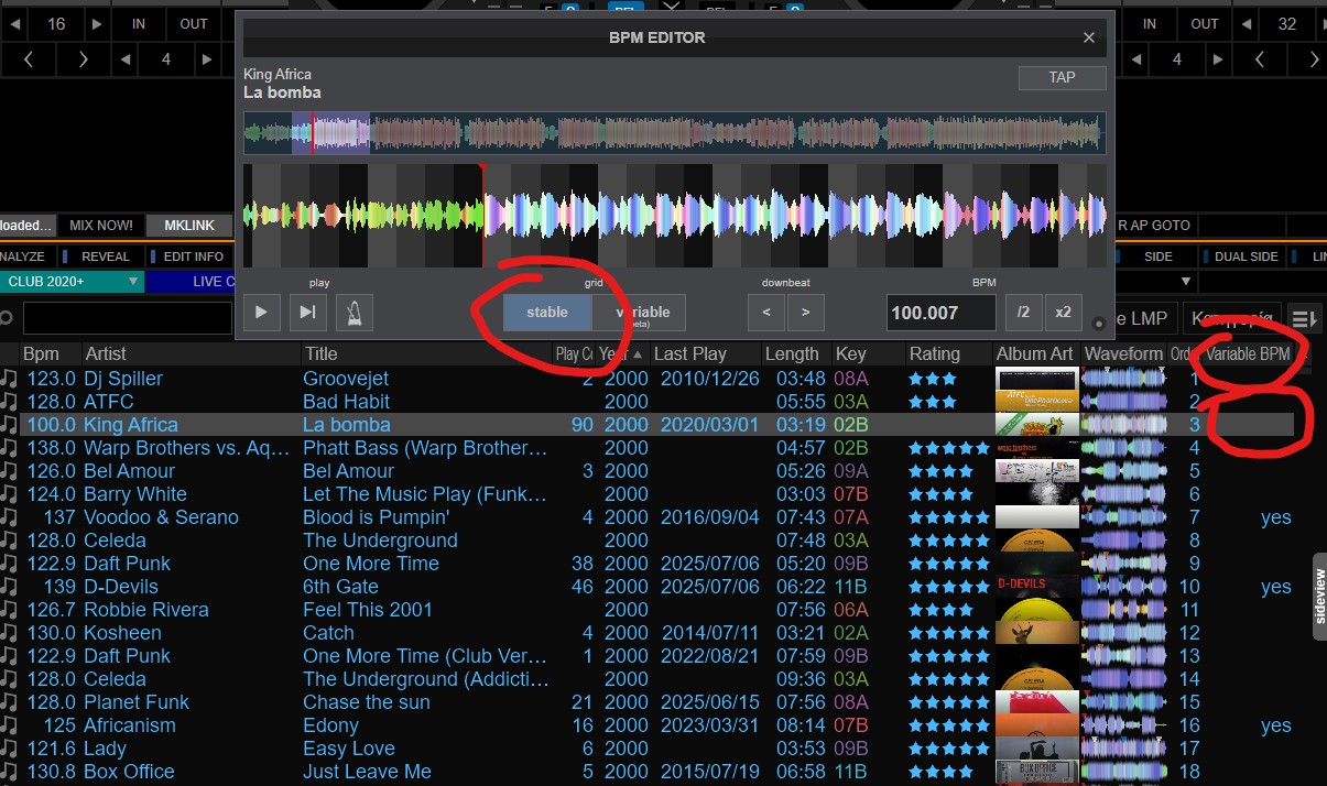

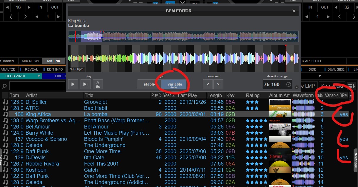

The BPM variable isn't showing anything for me !
neither yes
and no multi
Posted 2 hours ago
Werner, that info should show up, once you have analysed a track using the BPM editor only
Posted 2 hours ago
Are you sure ?
This is with variable bpm set:
And this is with stable:
Posted 2 hours ago
RobRoy wrote :
Werner, that info should show up, once you have analyzed a track using the BPM editor only
Yes, as explained on the [NEWS] thread, the new BPM Engine does NOT set a track automatically to variable BPM.
You have to use the BPM Editor (when stable BPM won't cut it) to switch to variable manually.
In the future it will suggest and/or switch to variable BPM automatically based on how much variation exists on a track's BPM, but not for now!
Posted 2 hours ago
