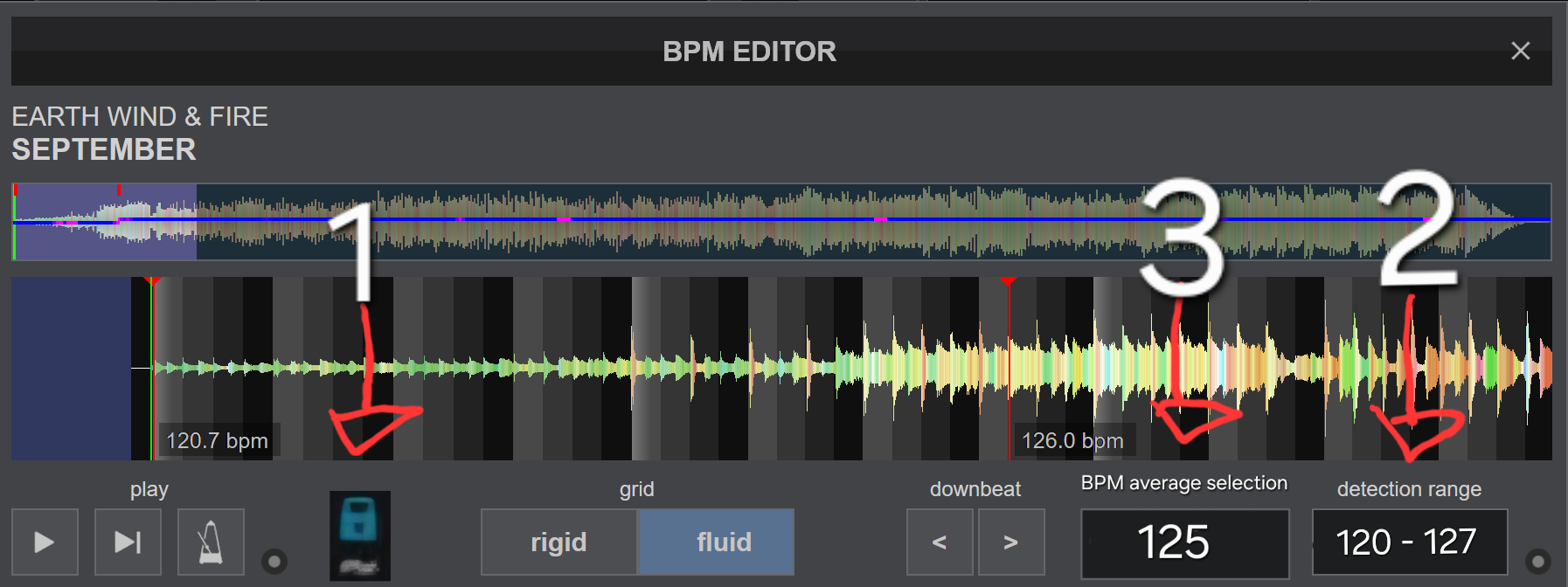

It locks at whatever the BPM is at the time you engage it, so if you lock when the BPM is 154 it will stabilize at 154 - the trouble is most of the BPM changes are invisible now. Unless it's a large change, neither the editor or the deck gives feedback to the user.
With the previous system, variations were visibile, so you could easily select an area, see the BPM and decide to lock at that tempo. Now the variations don't show and the track is made to look rigid.
See recent EWF example where the BPM shows a constant 126 for most of the track, when it actually increases gradually.

Stabilization is based on what the actual grid looks like and what the BPM is at the point of its activation, so if it sounds off, first check the grid to see if it's correct in that area.
The per song stablize BPM is a good idea, and would probably cover stabilized export as well.

But @groovindj aren't the shifts displayed in deck info display?
It's only the Jog display that keeps the stability value, and tbh that's the truth of what's happening on playback if the deck is stabilized (the BPM is kept steady).
Posted 3 days ago @ 12:52 pm
I've not seen them displayed elsewhere - even in the editor, many tracks now just show one anchor, one BPM and a straight blue line. Yes there are sometimes red areas, but even if you zoom in on those areas, it doesn't always show you a BPM value there.
I had a track recently where I had to place anchors manually throughout, as the analysis couldn't understand it (Hugh Masekela - Grazing In The Grass) and if you do that, you get a readout when it passes the anchor - but surely the idea now is to avoid manually placing anchors?
That's because the BPM doesn't really change. It's the phase changes that cause the red areas.
At least that's the case on the tracks I checked myself.
If you have any track that has a significant BPM change that's not displayed, feel free to share! :)

All I wanted... is if a "lock" could be added to the BPM editor so that when we want to permanently lock the fluid... it's annoying to have to remember to press the lock all the time.
