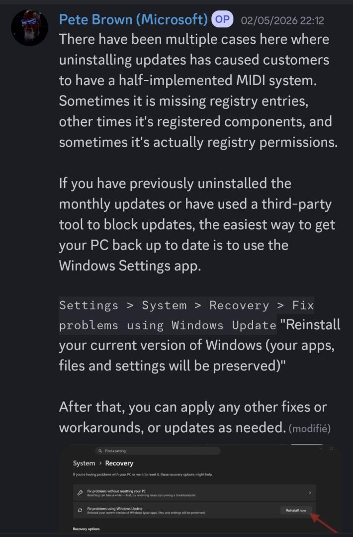

Posted Sun 28 Jun 26 @ 11:23 am
Pete Brown (Microsoft) wrote :
# June Fixes (all via CFR during the last week of June) KB5095093
- Ability to turn of the new stack and revert to the older MIDI stack if, for example, you have a device which will not work under Windows MIDI Services (like those with DirectMusic drivers), and do not need the multi-client and other capabilities. Thanks to Gary for taking this on and providing a good in-box solution (this required coordination across several services and APIs).
- There will be three modes: 1) Legacy stack only, 2) hybrid (MIDI 2.0 devices through new stack and new API only, everything else through legacy), and 3) fully enabled, as today. - Update to force `midi = wdmaud.drv` and `midi1 = wdmaud2.drv` in the registry upon reboot (or any time Audio Endpoint Builder has been restarted). This is to help eliminate the Korg driver uninstaller issue.
- USB MIDI 2 fill stream crash
- https://github.com/microsoft/MIDI/issues/1001
- https://github.com/microsoft/MIDI/issues/1005 - Improved USB MIDI 2 driver handling of peripherals with malformed descriptors
- Couple of low-frequency service crash fies
- WinMM performance improvements for retrieving device count
Posted Sun 28 Jun 26 @ 11:28 am
