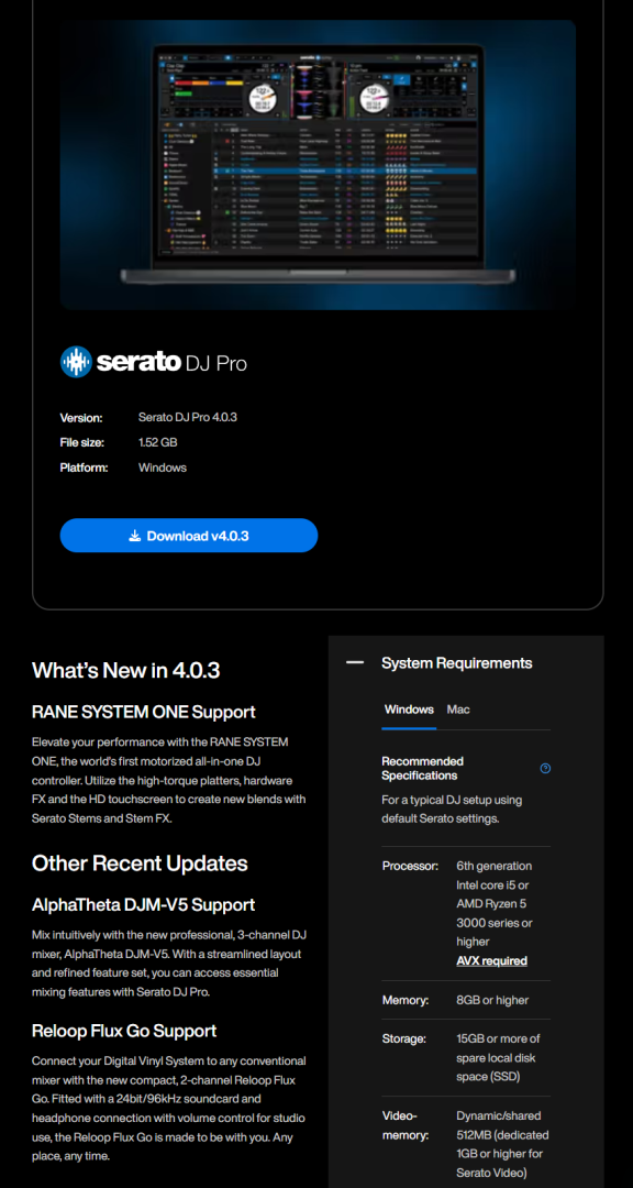

Looks like Engine OS 4.6 and Serato support is dropping today!

You cannot sync between serato and engine sources, u can sync from engine sources and any streaming source, you also cannot initiate a search of tracks in your serato library from the system one unit directly, searches of tracks in your serato library have to be initiated inside serato on the laptop, u can view your serato crates directly on the system one screen, just can’t start a search..if there’s a way to do this then I must not have looked hard enough. U do have access to all hardware, fader, and touch fx regardless of sources used. Have had the unit since it launched Jan 20th and have done numerous gigs with it. Used it this past weekend with serato attached in case. Mainly for realtime stem processing also a bug I’ve noticed is occasionally you cannot load a track from serato library onto a deck even if it’s not playing from the unit itself, have to click inside serato and load it from the laptop after that, loading on the system one from serato library functions again.

The Serato search limitation was (is) exactly the same on earlier units.
When Serato became available for the Prime 4 I gave it a try and found I was unable to search from the controller. I thought it was ridiculous then, and never used Serato with my Prime 4 again. 🤷‍♂️
