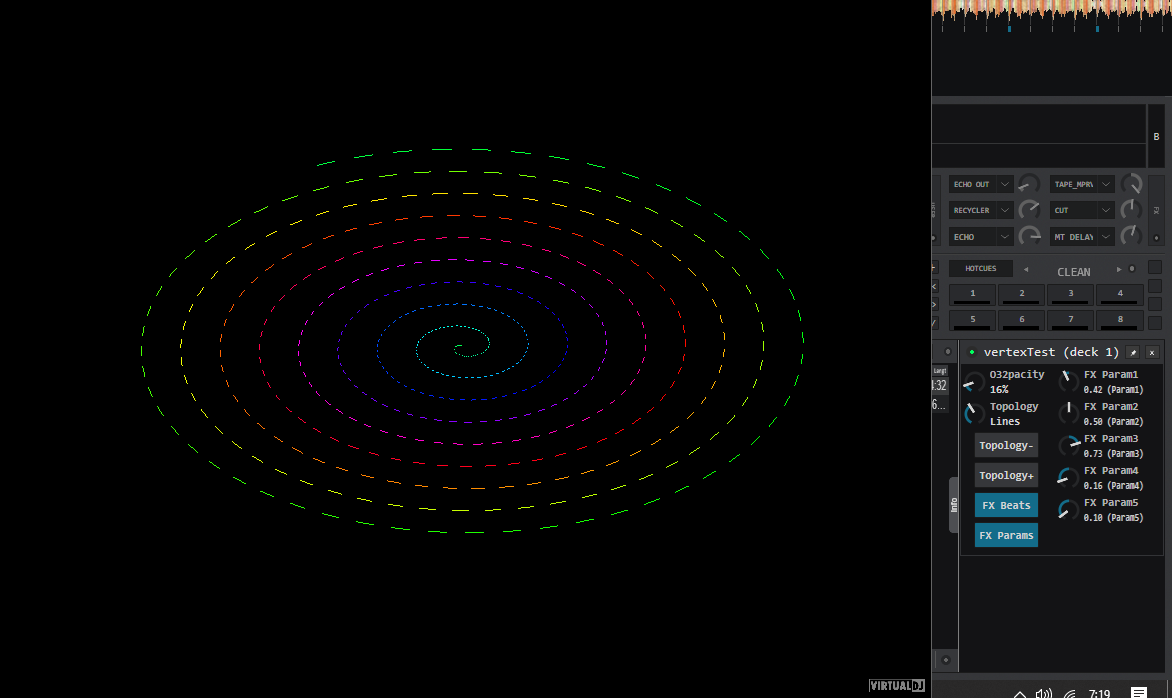

eugh I remember comPtr from last dx11 project I did years back.
You've got to remember, I'm out of my depth on almost everything, anything new needs +3 tabs, every error is +3 tabs, every tab is +3 tabs.
Easy errors for a CS background, I learnt by online tutorials build a calculator, half watched half remembered [from sometimes half arsed] YT video
But progress, I dropped all the frag shader stuff as it was just confusing keeping that working and adding the new.
an animated hard coded vertex shader
Posted Wed 12 Aug 26 @ 6:59 am
