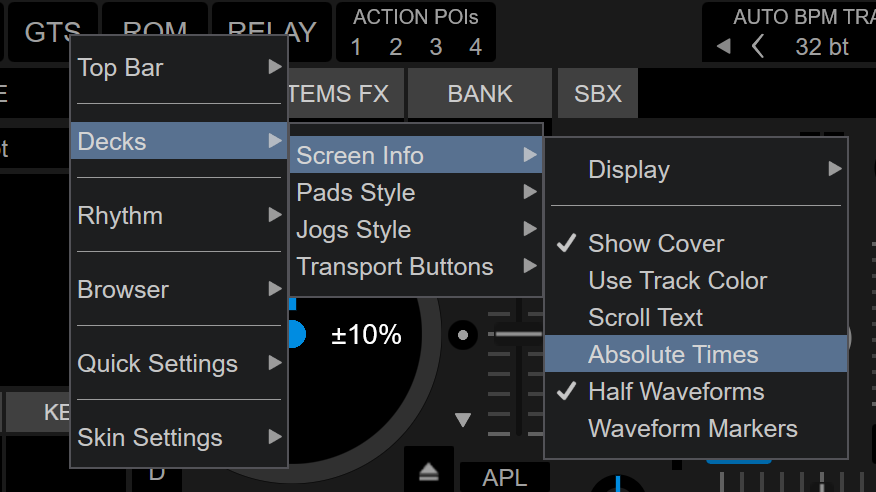

You can also try to use this skin:
https://virtualdj.com/plugins/?addonid=81906
It has an option to use "Absolute" times from version 1.0.41 onwards
Posted Mon 29 Dec 25 @ 11:59 pm
