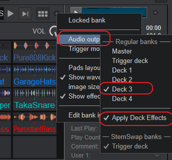

On my old controller DDJ-SX2, I routed the sampler output to channel 3 so I could adjust the bass and treble. It was possible to pre-listen to the sampler on channel 3. On my new controller DDj-FLX10, I’ve done the same, but I can’t hear any thing on channel 3. Is that not possible on the FLX10 because of the hardware mixer?
I have routed the sampler output in the skin gui - pad menu. Should i revert it and route the sampler in audio settings instead?

I have the the default setup and i know it has a Sampler cue button, but as i describe, i have routed the sampler output to chan 3 to adjust low and high. I cant pfl the sampler on chan3 or Sampler pfl.
Sampler is playing on master, i can adjust low, high and level and vu meter on chan 3 is vissible.

Ok so you want the ability to use the 3-band EQ of the mixer section of one channels on the sampler?
Posted Mon 22 Dec 25 @ 3:01 pm
Yes that is correct and it works perfect, BUT i cant pfl the sampler. On my old SX2 it works when i press the pfl button on chan 3 but not on my FLX10. Same routing settings but no pfl on chanel 3 or sampler pfl. Samplersound out on the master working.

when routing Sampler to a Deck with Master & Headphones, e.g. on Deck 3 and need to apply software EQ, you need to have checked "Apply Deck Effects" as per the following image...
For prelisten. The PFL_SAMPLER key on FLX10 (Nr.17 in our Manual) is mapped to toggle the setting SamplerHeadphones, but will not do anything if Sampler is assigned to a Deck.
But you should be able to prelisten Sampler in Headphones if the PFL button is enabled on Deck 3. You dont ?
PS. Don't add Sampler in your Audio setup, leave it to just Master & Headphones. the routing is done from within VDJ Sampler Options as shown in the pic above.

I have all this setting as you describe. I can only hear the Sampler pfl when the fader on the chan 3 is up

Either disable 'Apply Deck Effects', or set 'fxProcessing' to 'Pre-Fader'
Posted Tue 30 Dec 25 @ 9:08 am
When I disable “Apply Deck Effects”, I can 'pfl pre fader' the sample, but naturally there is no VU meter and I can’t adjust the highs and lows. So I can’t disable “Apply Deck Effects”. I assume the internal routing and the hardware in the FLX10 doesn’t allow PFL pre-fader and doesn’t work the same way as it does on the DDJ-SX2. Maybe can @phantomdeejay confirm?
