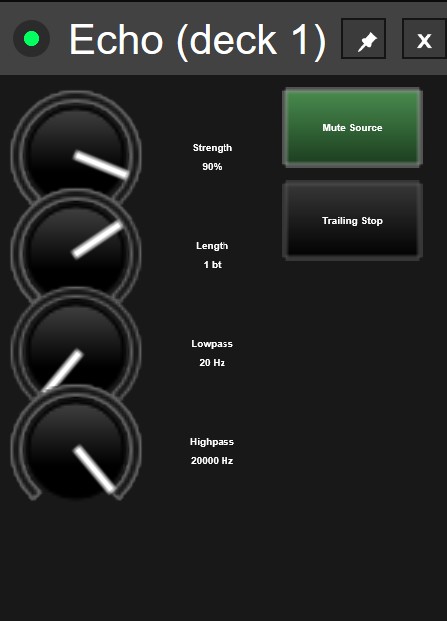

Legacy echo:

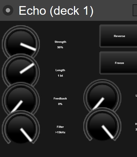

New Echo:

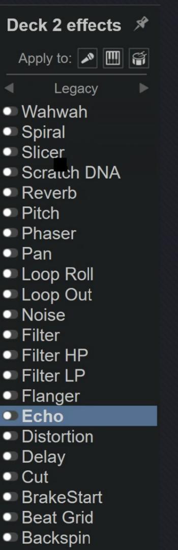

Did you select the "legacy" effect list on slot 3?
Thanks for the quick reply.
yes have selected the Legacy "echo" for slot 3.

How do I script the "Legacy echo" in VDJ 2026? I like the "Mute Source" of the legacy echo, seems not to be there on the NEW Echo.

Note: Parameters for the legacy echo are set as pictured above.

PS also currently I cannot get the New echo to sound anything like an echo effect. What am I missing?

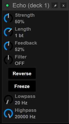

Or at least try to set the settings as per the pic below:
IIDEEJAYII wrote :
New Echo:
I don't know how you end up with such settings, but yes, they are completely messed..
1) Feedback (slider 3) should be more than 0% in order to sustain some kind of echo
2) Filter (slider 4) should be at the middle. Currently it sits at full highpass (as resonant filter, not to be confused with lowpass and highpass sliders 5 & 6)
Try this on a custom button in order to reset the effect without the need to delete the ini files
effect_select 3 'echo' & effect_slider_reset 3 3 & effect_slider_reset 3 4 & effect_slider_reset 3 5 & effect_slider_reset 3 6 & effect_active 3
