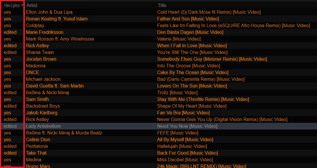

Hey Stephane
As I have made a couple of songs that I dont want to edit (dont have the time or effort) and it wont be fixed with Re-analyze.
Could you make a "delete" button to make the browser field "Has Lyrics" to be reset without the edited still showing.
As the reset in the editor just jumps back to the last analyze?
That would save time to see what files that really have been good with text.
