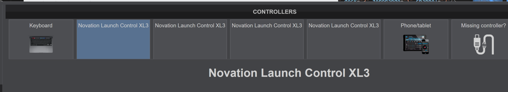

1-The LCXL3 has 4 devices: (in+out) normal MIDI mode and (in+out) for DAW MIDI mode. I figured that VDJ input is on port 1 and VDJ output should be on port 2 for normal MIDI mode. VDJ discovers the 4 devices. As we speak, data is well recieved on port 1, but I cannot send on port 2. Do I need to prepare a second definition file? Should the vid or pid be different for VDJ to figure out which port is which?

And for my first question? Should I do a single definition file and create 4 mappings (out-MIDI, in-MIDI, out-DAW and in-DAW) and assign them to the respective controllers shown in this image?
They are not described better but I can find which is which by trial and error.

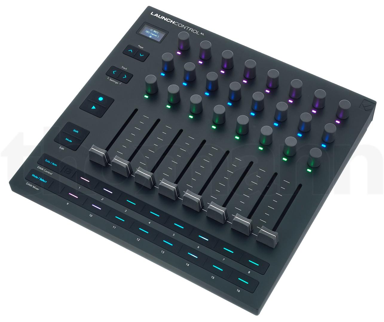

The Launchcontrol XL3 looks great.
I don't know if I could justify a purchase, or realestate, as I currently have a Midi Fighter Twister and Launchpads for needed knobs and buttons.
For use would maybe like, one bank to allow control of all the FX 3 slots and each of their parameters, with the strength using the fader, plus any additional knobs for maybe 2 or 3 extra CFX knobs (effect_colorfx 1-4)
Another maybe useful bank, to have deck 1, and deck 2 being knob rows 2 and 3, respectively, with the knobs being the stems (maybe EZ-Remix), and the Frequency EQs (Hi, Med, Lo) and the faders below each of the Stems would be used as Stems crossfaders, to Crossfade the respective stem above it, or crossfade the Frequency EQ, above it between decks 1 and 2.
(and fill in any unused knobs with CFX (effect_colorfx 1-4).
And use the pads for, Jumps, and setting loops, maybe on each of banks, and maybe a few instant filters (quicksearchs), and some gotofolder and gotolastfolder pads, for quick navigation.)
