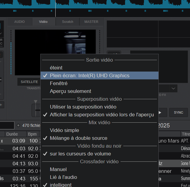

Hello, Virtual 2025's latest update is V2025 B8818. Previously, my second graphics card, GeForce, appeared in the menu (right-click on the video). It's no longer there; I only have the Intel UHD graphics card. My GeForce RTX 3060 graphics card is properly activated, and no problems are detected in my devices. In Virtual's video and performance settings, it appears and is selected. What could have happened with Virtual? Did an update change something? Thank you in advance for your help.

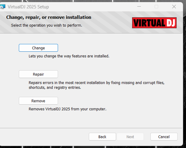

Which option do I select to reinstall virtual? Change, repair, or remove?

Adion wrote :
What is the problem exactly when you select the option, is it not showing on your external screen?
As explained in the first message, I used to have my second graphics card, GeForce, which appeared in this menu (right-click on the video). It's no longer there;
In the VirtualBox video and performance settings, it appears and is selected. What could have happened with VirtualBox

So you want to use your nVidia as VDJ Video Output.
Usually the nvidia graphics cards offer some right-click option on the exe (of VirtualDJ) to open with one or the other graphics card. Or you can select the nVidia (probably from nVidia Control Panel) to be your default graphics card.
If selected with one way or the other, then VirtualDJ will use that card.
As for the VDJ installation, do the "Repair"

That's exactly what I explained in my first message; everything was done that way, but the card no longer appears in the menu. Before, I had both cards available, now I only have one.

This dialog is meant to select video outputs, not which graphics card to use.
So you mean you have another monitor connected to the RTX that you can't select there?

Thanks, but I already did that. I don't understand what's happening. Before, both cards were displayed correctly in the video output menu. I'm trying to figure it out.
