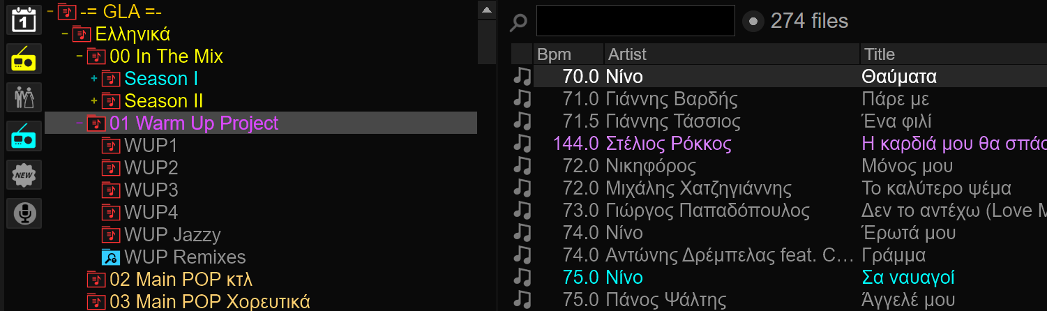

In VirtualDJ it is possible for a "folder" (being physical or virtual) to have both songs and subfolders / sublists nested inside the root.
This means that your code will not work for such cases.
01 Warm Up Project folder above, contains 274 songs and 6 subfolders..
Therefore the script above won't work properly here.
I'm not dismissing your script. I'm just saying it won't work for everybody.
