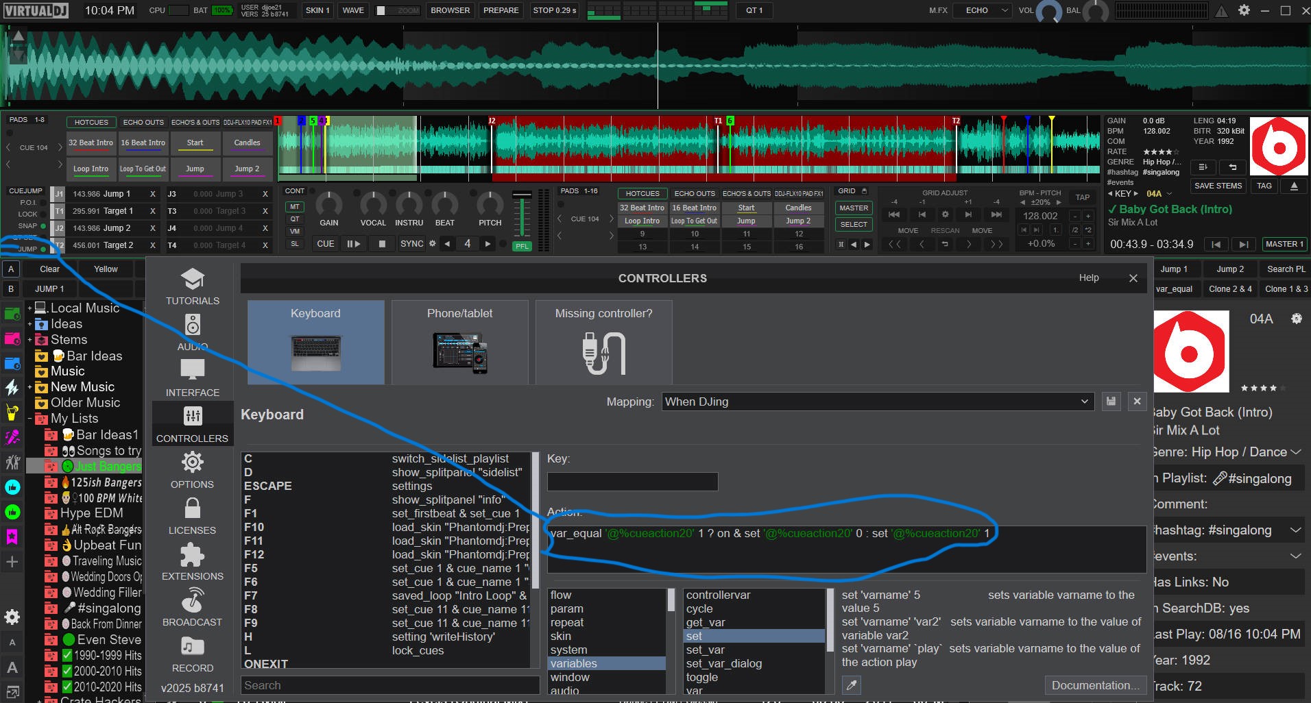

I'm using the Project Control by Dennyo in prep mode and I noticed he has a Jump mode in it (see pic 1) when I set the jumps and the targets the only way to turn them on that I can figure is to use the mouse to toggle that little tiny button. I like this feature because I prefer to have full song versions and make short edits and quick hits as need without have separate versions. I use an FLX10 and I'm looking to if possible link this to the Link button on the controller. I know how to map but can't figure how to set up a button toggle.

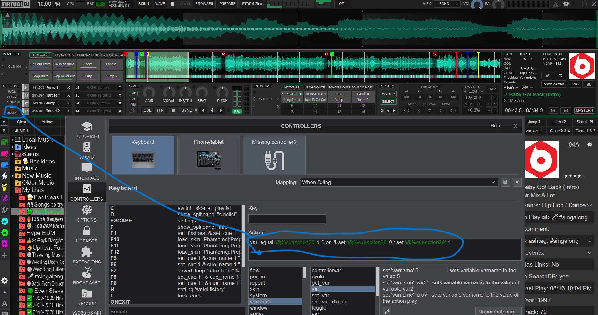

Little part 2? I notice in this skin you see in pic 1 when Jump is on it highlights the part that gonna be skipped. Pic 2 you can see when its off nothing is highlighted or skipped. I only see this in this skin it does the skip in all skin but that part being skipped is not highlighted. 'm guessing can't do anything about that but thought i'd ask.
Thanks
Joe
