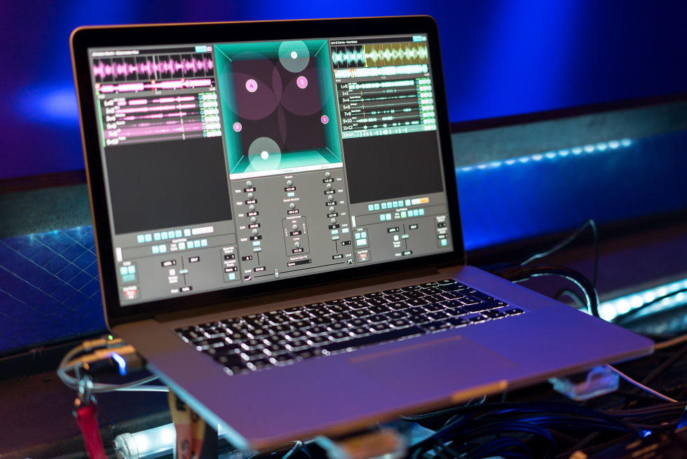

Dolby Labs brought out this software several years ago:
I think it is more of a Dolby panner than something that decodes the Atmos file.
