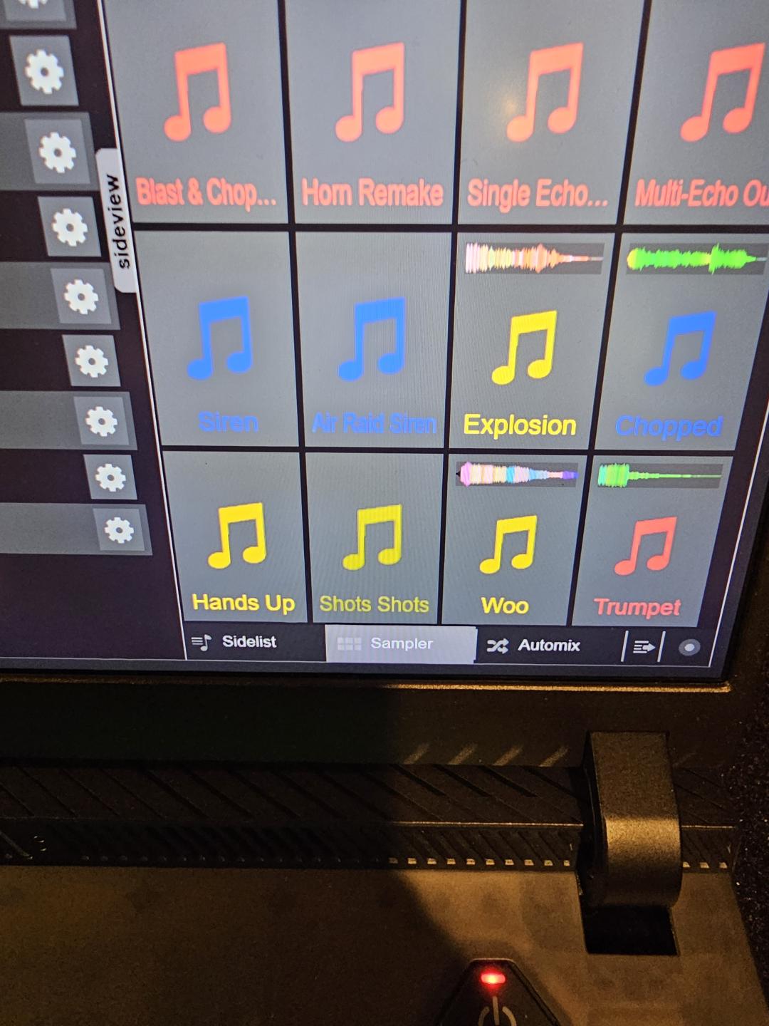

Here is a pic; the siren, air raid siren, hands up, and shots are all unusable.

Thanks for that. I just downloaded and tested on my desktop (with no controller connected) and those 4 samples still dont work for me. I cannot trigger the sampler pad (as shown in my previous screenshot) or access the sample edit screen.
The odd part is 3 out of the 4 which are not working for me are stock VDJ samples. They are not ones which I am adding myself. How can I get the embedded VDJ samples to work as they have for years now?

If they don't play or open the editor then most likely the source files are actually missing

You are spot on, and I have no idea how that happened. When I search for the underlying files within the file explorer sampler folder, I dont see them. I added one back from an old backup and its works as expected..
Thank you adion! Now to figure out how they got deleted...
