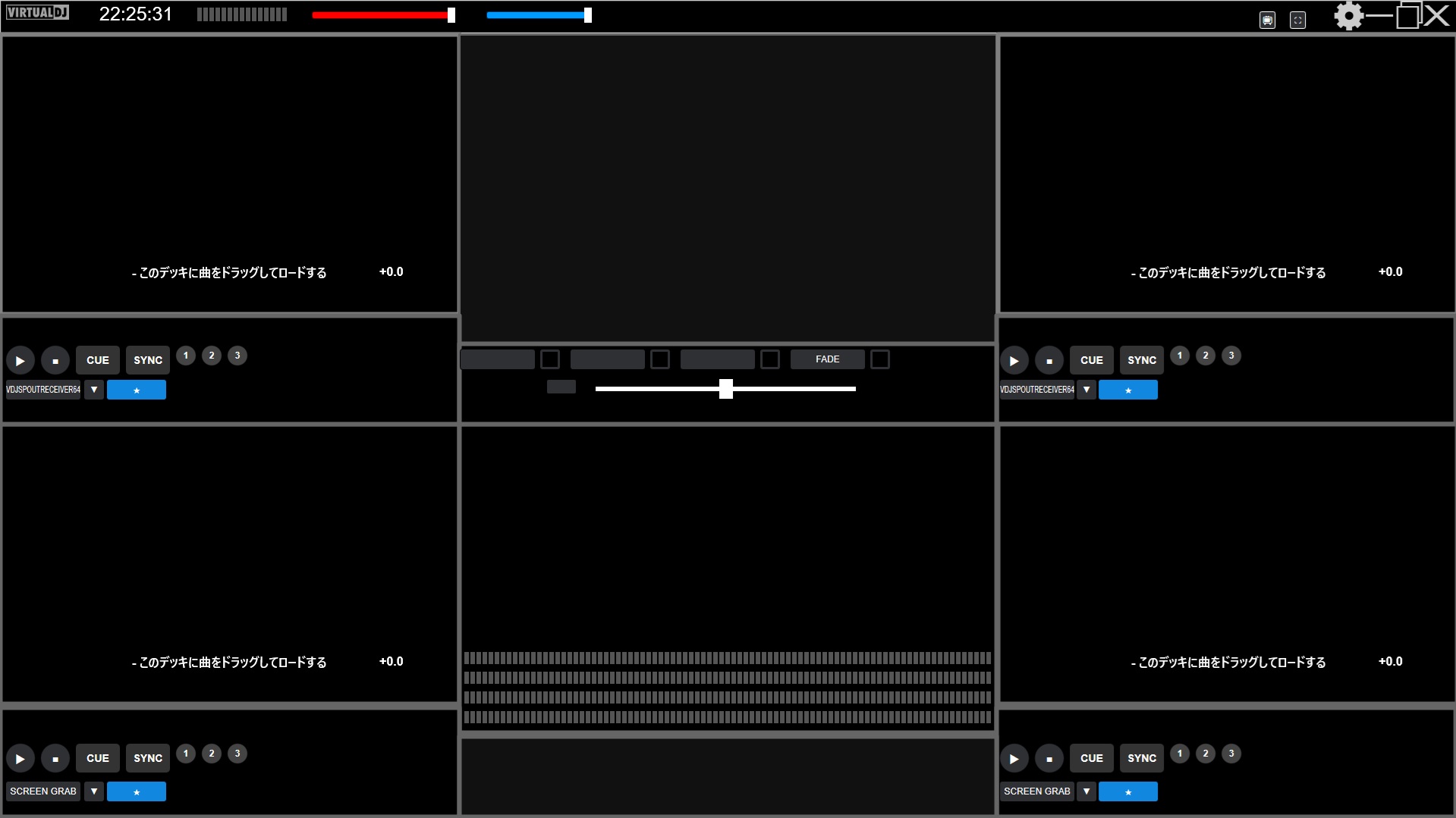

I'm currently creating a 4-channel video skin.
It's a very easy and simple skin, which is why I'm asking this question.

There's nothing under the browser.
In fact, there's no browser at all.
Posted Mon 15 Sep 25 @ 12:14 pm
That's your issue then..
Let me explain..
VirtualDJ uses 2 methods to resize the skin:
1) proportionally: All the skin elements are resized proportionally to their original aspect ratio.
2) Non proportionally: The browser, OR the area between the breaklines is resized without keeping the original aspect ratio.
This effectively means that all the skin elements will resize in a way that keeps their original aspect ratio, and only the browser (OR the area between the breaklines) will stretch to fill the rest of the screen.
Since your skin doesn't have a browser element, the above logic doesn't work.
Now, is this a SKIN or skin window ?
What are you after ?
Can you post a screenshot of your skin without being resized ?
Posted Mon 15 Sep 25 @ 12:38 pm
It's unfinished, but it's a simple 4ch video skin like this.
Posted Mon 15 Sep 25 @ 1:27 pm
