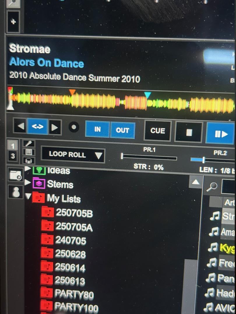

Adion wrote :
So the number of beats shown in vdj doesn't change to the number of beats of the saved loop when you activate it?
I already had a saved loop for the track in the picture below and when I press the "hot cue / saved loop" button the number of beats in VDJ change to the beats of the saved loop.
On the other hand, if I create a new saved loop today and store on another hot cue / saved loop slot, the "loop adjust symbol" appears where the beat number is.
The loop adjust symbol appears also when I activate the saved loop by hot cue button.
And if I use button "RELOOP (36)" the beats of the loop will be according to what number says in VDJ.
Please note this is with XDJ-RX3!
Posted Wed 23 Jul 25 @ 9:41 am
