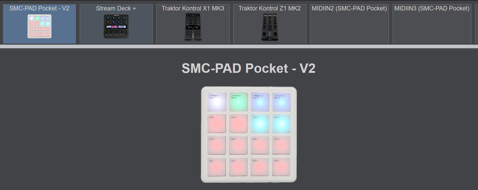

Hi All,
I use a SMC PAD Pocket with Virtual DJ. The SMC has 3 MIDI devices and they use the same "vid" and "pid". Therefore the 3 devices are showing up in VDJ.
I can separate the 3 devices via "drivername" in the Definition File and it looks like that now:
Is there a way to disable/hide MIDI devices in VDJ?

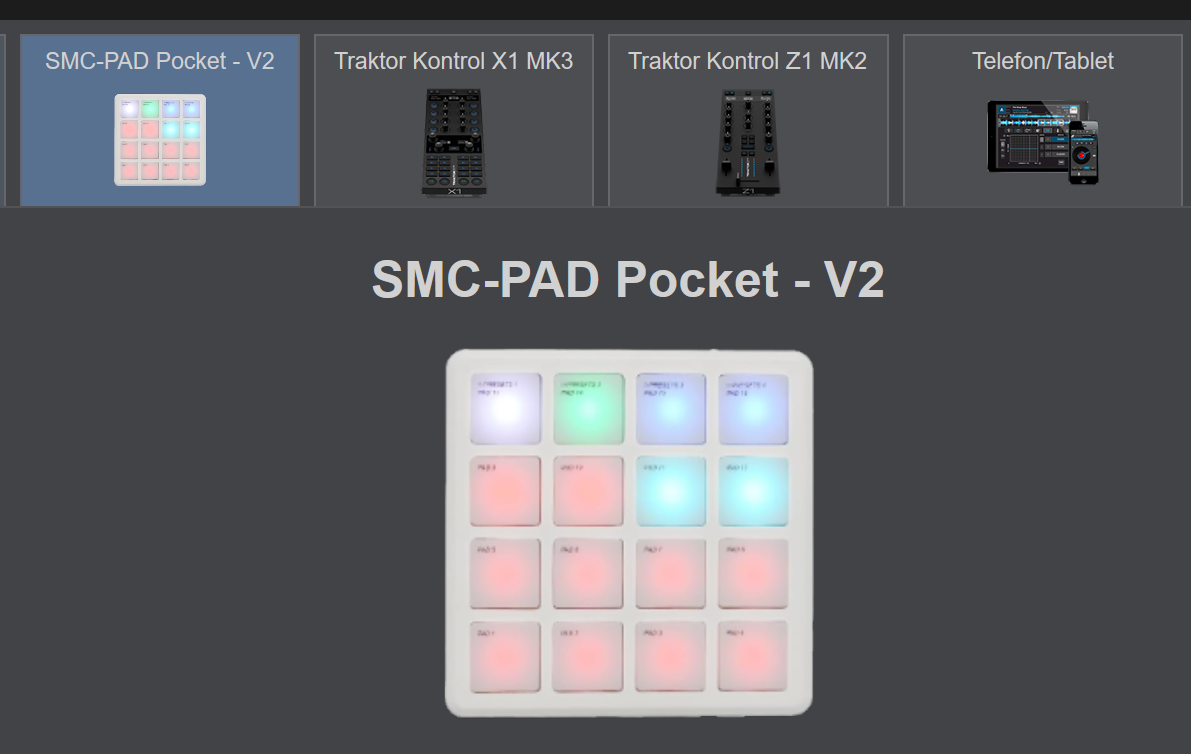

Many thanx,
to use
ignore="true"in definition files works :-)
The SMC Pad is only displayed once now, perfect!
