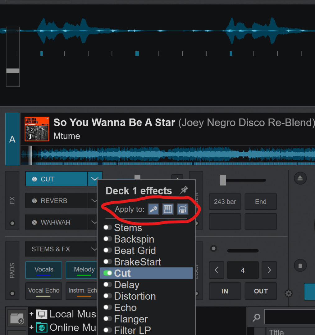

I noticed a bug in the release b8645. Deck FX not applied when all stem type are active.
Steps I made:
1. Go to the Pro layout
2. Load a track to Deck A.
3. Select the Cut FX on the deck and select all 3 type of stems from the dropdown section "Apply to"
4. Start playback on the deck
5. Enable the Cut effect.
Actual result
The track continues to play without any effect.
Expected result
The Cut effect should be applied to the playing track. Essentially applying all stems or no stems should have the exact same outcome.
I reverted back to build b8615 and it works well.
Steps I made:
Actual result
Expected result
Posted Thu 26 Jun 25 @ 7:32 pm
This is fixed in Build 8678.
