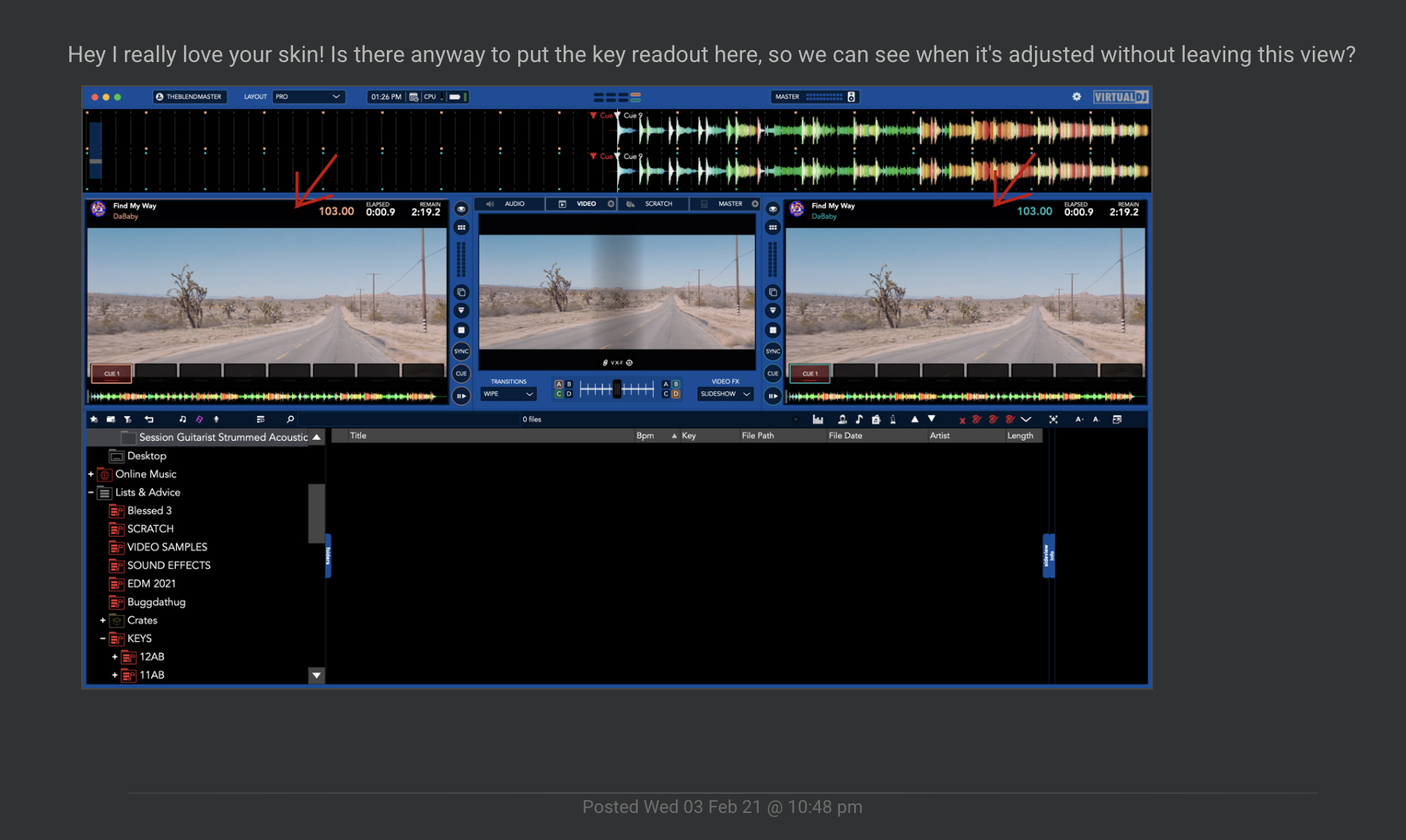

Would it be something like this you're looking for? This is created from Dan's (djtouchdan, VDJ Moderator) Project X skin from around 2021. I don't use this display, but I have used this skin for the last few years, it has lots of options; there's also a Project X Slider skin that slides open or close the rhythm display.

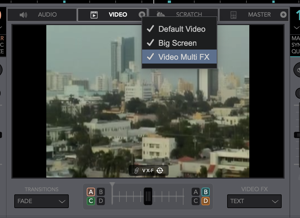

I've just re-read your query and think this maybe what you want. It is still Dan's Project X skin.
Click on the video tab and there is a gear button at the right of the video tab then click on the Big Screen. I think that is what you want. See below screenshot;
