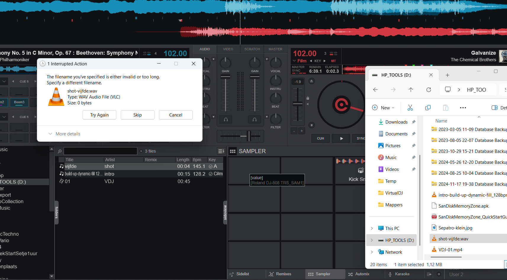

Sepatro wrote :
Thanks, but that doesn't work. First of all, I get a kind of split grid (left & right), and I can't drop the .wav in the left pane (I get an error about a filename being too long which makes no sense). When I drop it on the right pane, it doesn't show on the pads. Secondly, editing the sample doesn' t work (doesn't get saved).
The pads on the right are for the right deck, on the left side for the left deck.
Perhaps no song was loaded on the right deck so nothing would happen.
Could you post a picture of the tag editor of the .wav you are trying to add?
Hello, here is a picture of the error message I am getting when dropping a .wav from an USB-stick to the left panel.
Posted Mon 12 May 25 @ 9:05 pm
I see, the problem is not with the sample, but with the song you are trying to assign it to.
The ":" in the song's title probably cause the issue.
Posted Tue 13 May 25 @ 4:53 am
