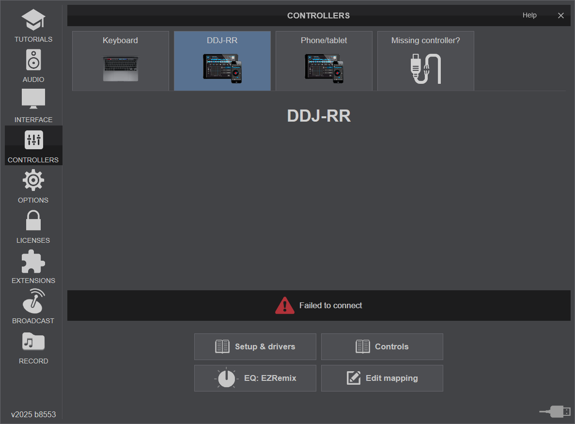

Suddenly no one of my two controllers would connect and or be found in the controllers.
Why is this trolling me? Working supurb yesterday, Today No controller is there. No config, no nothing

Problem is the more I mess with setting, the config will be messed up. Can't figure out what is going on

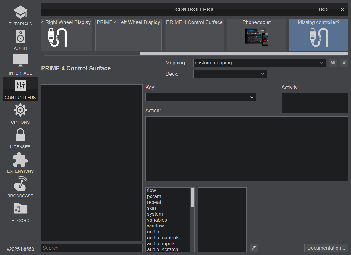

Neither will Virtual dj find my old ddj-rr or Denon Prime 4.

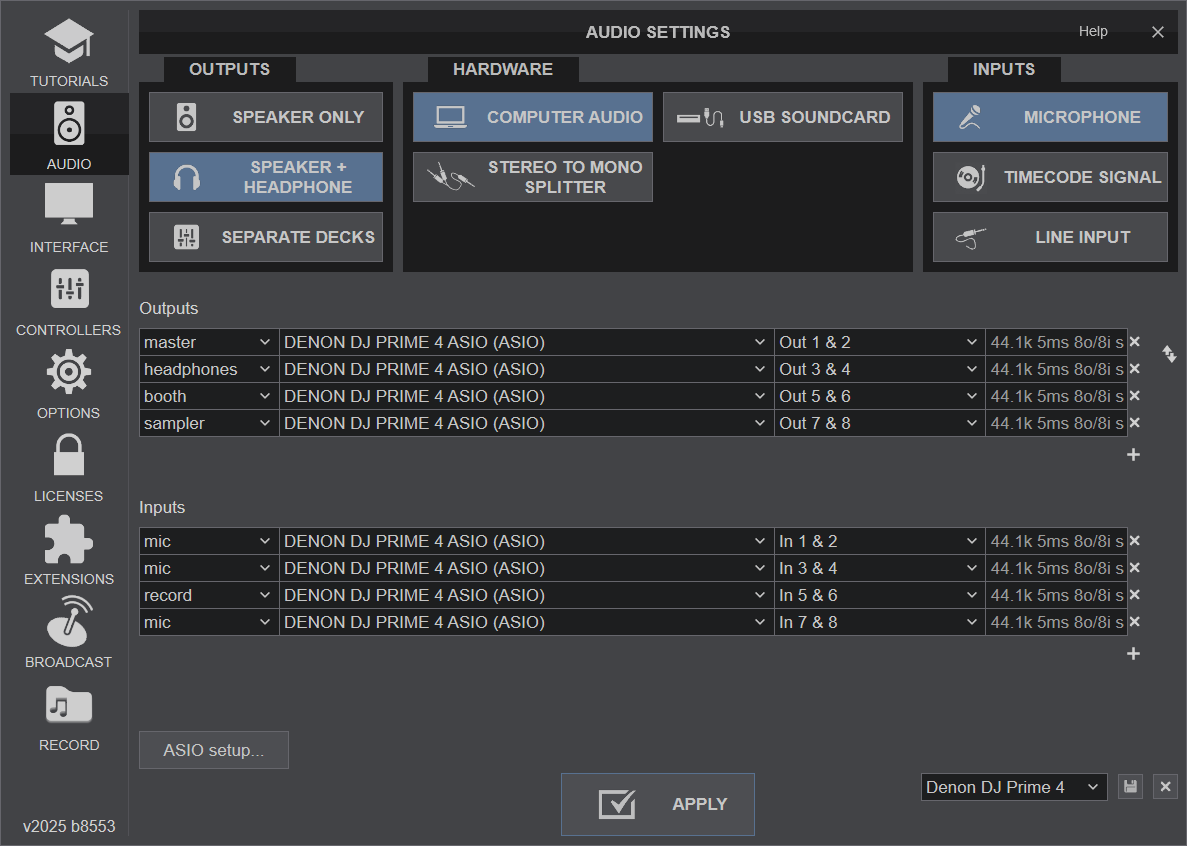

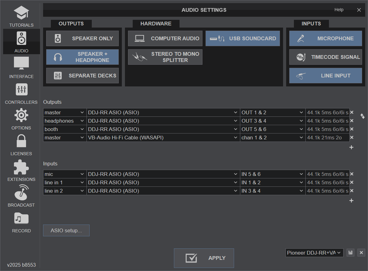

It is finding the audio drives and apply but the controller configs are totally gone

Needed to uninstall VDJ, a re-install and transfer old settings to get work again
