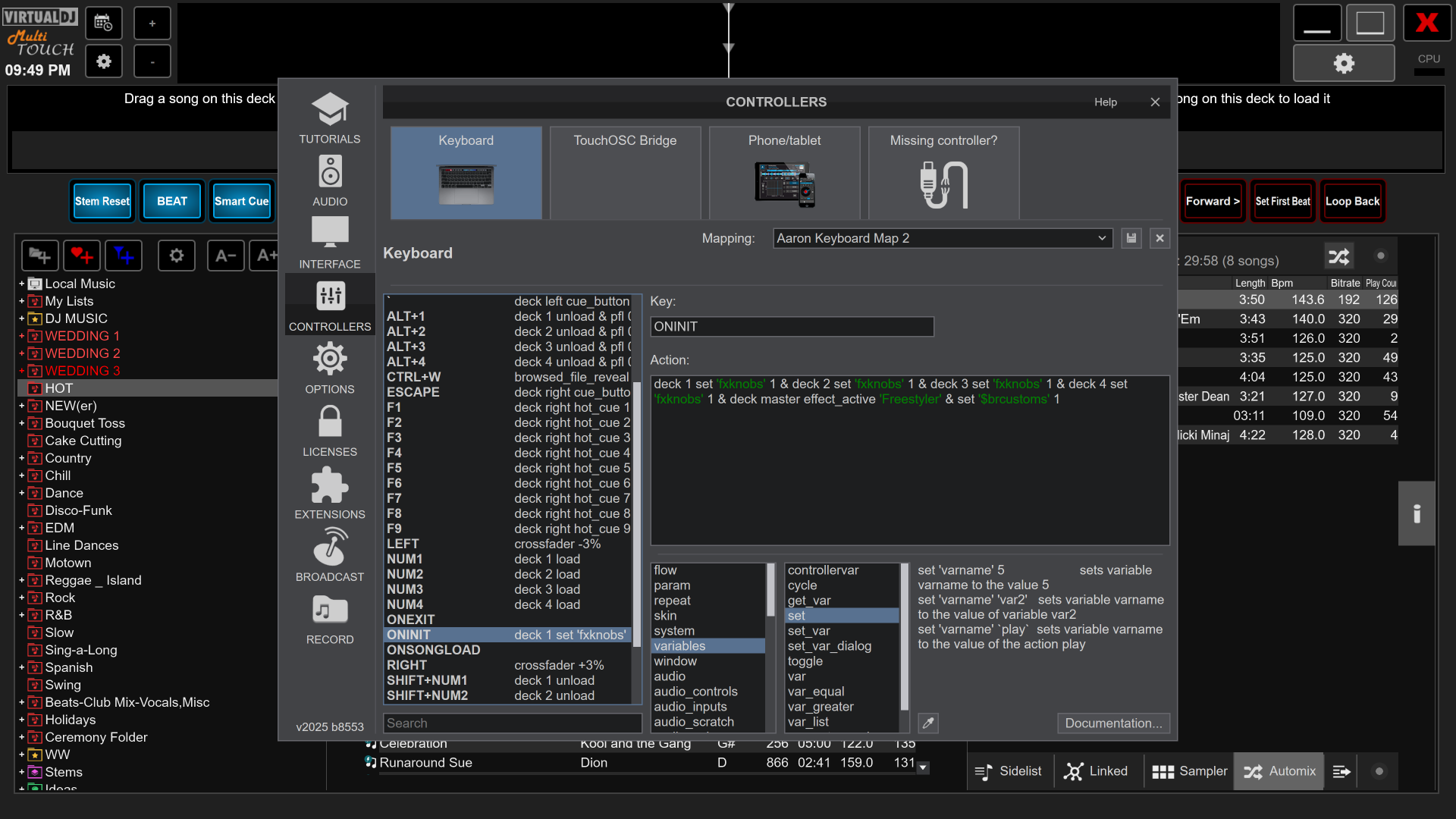

use keyboard oninit to set deck master, then set deck all

I can find ONINIT for keyboard.......but how do i set "deck master and deck all" for the echo, (keep in mind echo settings will be different for master and decks.....)??

-Settings
-Controllers
-Keyboard
-Advanced Editor (Bottom Right)
Posted Sun 20 Apr 25 @ 1:54 am
( deck master effect_select "Echo" & effect_slider 1 30% & effect_slider 2 50% & effect_slider 3 0% & effect_slider 4 50% ) & ( deck all effect_select "Echo" & effect_slider 1 50% & effect_slider 2 25% & effect_slider 3 10% & effect_slider 4 100% )
Just change the sliders to where you need them by changing the %
Posted Sun 20 Apr 25 @ 2:48 am

after a deck is specified it doesn't need to be specified again while it is the target
Similar with deck all, you have to be even more careful with deck all, the way you did it would have been 1024 commands for a 4 deck rig,
see script school "deck all" topic to understand why.

That script works perfectly, after i fine tweaked the parameters, it does exactly what i want.
The only additional option i would like is to have the master effect active when i start VDJ.....

then call effect_active on with deck master,
oninit might be something new to you but something as simple as turning an effect on via script you should be able to manage yourself.
