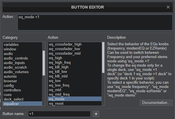

If you use the action eq_mode, you can use the above parameters, plus eq_mode + 1 which is toggling between Frequency and the selected Stems mode.
Both the action and the setting syntax are documented when you type an Action..

Thank you both. Using eq_mode action solved my problem. I didn't realize that was a dedicated action. I could not get the setting to work.
Appreciate both your help and quickness with answering, cheers!
