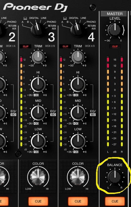

You could, but you shouldn't.
Those knobs will still work and do whatever they're doing on the DJM.
So, if you map "Master Balance" to control your sampler volume, it will work, but it will also PAN the sound left / right at the same time..
Maybe the FX Send/Return knob, if you don't use an external FX unit can be sacrificed to be used as your master sampler volume

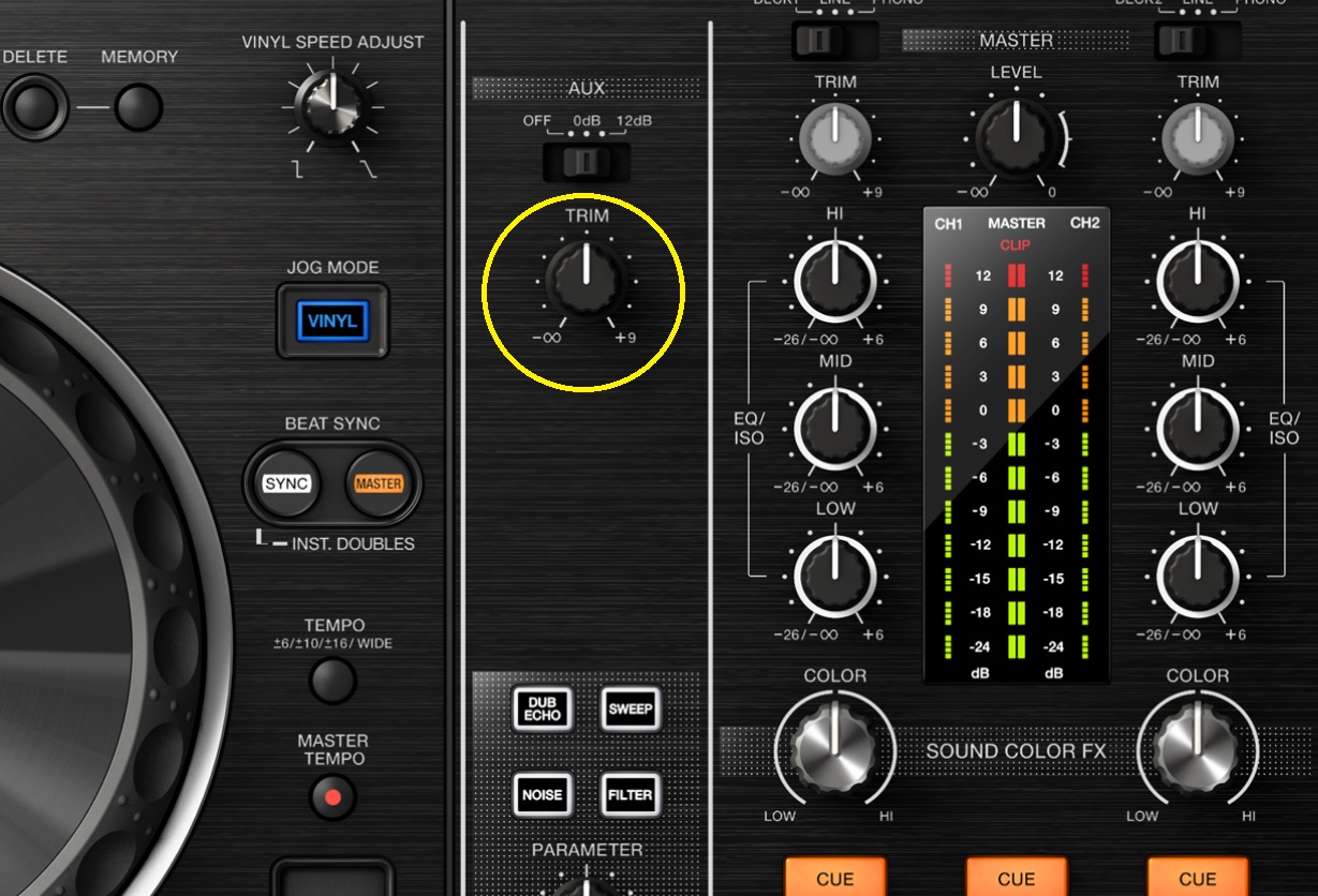

see the pipette by the number 12
and click the thing you want to know the script of.

What is a pipette? furthermore you show a DDJ-RR controller..
In anycase DDJ-XP2 should not be considered in this request....I just need to assign a VDJ action (control the Samples Volume) to a DJM-900NXS2 which is a mixer.

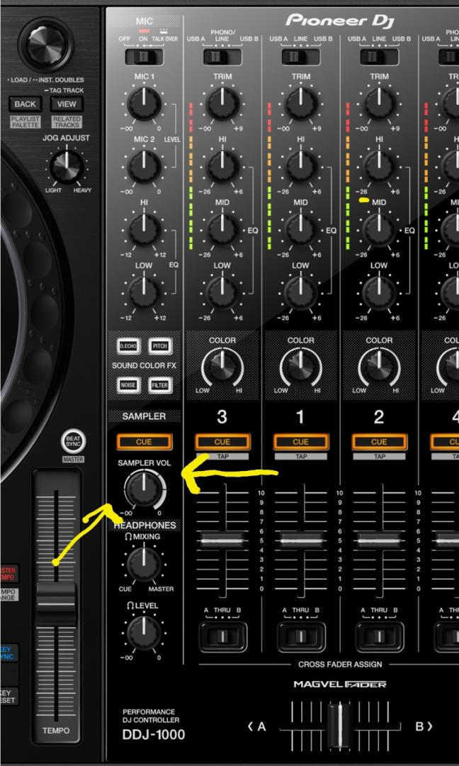

Just to be clear on what Volume Sampler I am referring to have a look at this picture:
For istance if I connect VDJ to a XDJ-RX2 VDJ automatically assign the Samples Volume to this knob
So I assume I can do the same choosing a DJM-900NXS2 knob which I dont use.

pipette = eye dropper, look at the pic I provided, look around the 12 mark.
Posted Mon 13 Jan 25 @ 4:15 pm

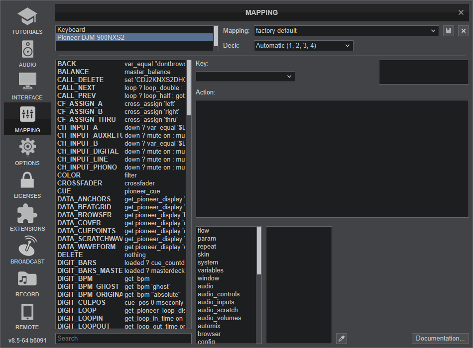

This is the mapping for DJM-900NXS2 as per VDJ HW Setup Guide.
As now I dont own that mixer, I can't see what's on that VDJ panel nor work on it.

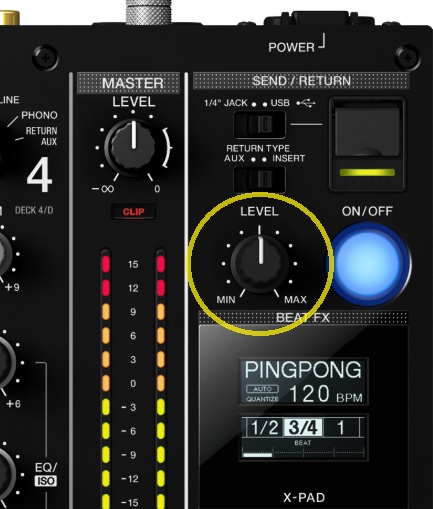

fx_sendreturn_level will be fine.
Posted Mon 13 Jan 25 @ 4:37 pm

locoDog wrote :
fx_sendreturn_level
That's the literal key name.
Posted Mon 13 Jan 25 @ 7:34 pm

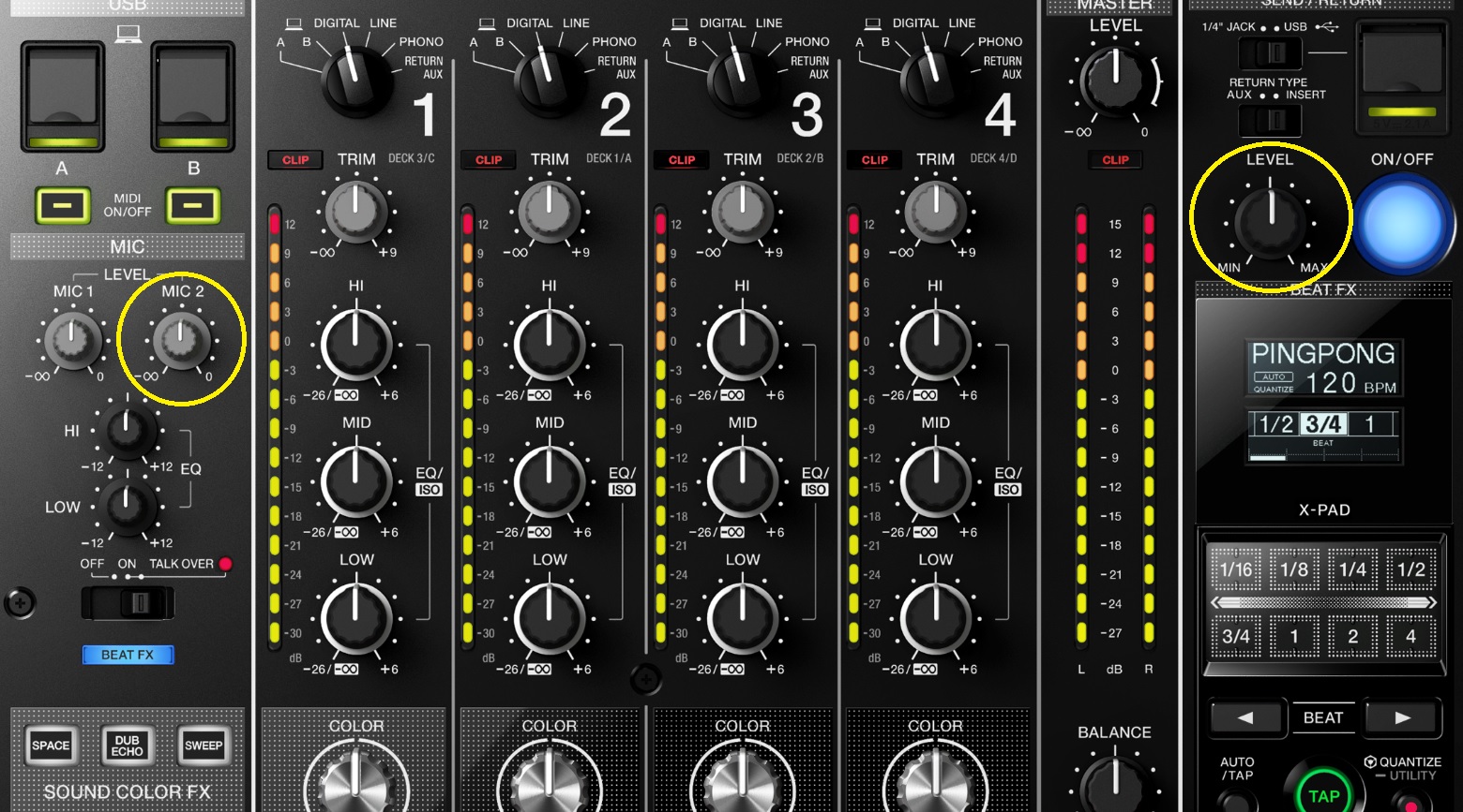

MIC 2 is not a mappable dial, you can see that from the key dropdown.
Posted Wed 15 Jan 25 @ 9:05 am

No. No-one is hidding you anything.
Here are the instructions on how to remap a button/knob (key) in VirtualDJ:
https://www.virtualdj.com/manuals/virtualdj/settings/controllers/index.html#custom%20mapping
This is where the picture posted above was sourced.
It's quite a simple process if you can just follow the numbers
Follow the procedure and remap a knob that you don't intend to use.
If you don't plan to use the microphones AT ALL then you can remap MIC_LOW or MIC_HI keys (the MIC EQ keys)
MIC1 and MIC2 LEVEL keys do not send MIDI.
Also the FX_SENDRETURN_LEVEL key (the external effects send/return level knob that you posted inside a yellow circle above) can also be remapped IF YOU ARE NOT GOING TO USE AN EXTERNAL EFFECTS UNIT.
Finally the action you need to type in is as simple as it gets: sampler_volume_master
Posted Wed 15 Jan 25 @ 10:16 am

Cant find those buttons on the remapping menu of the mixer.....nothing microphone related....
