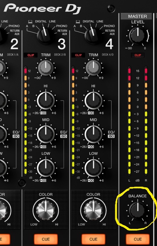

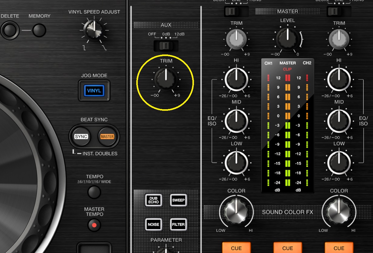

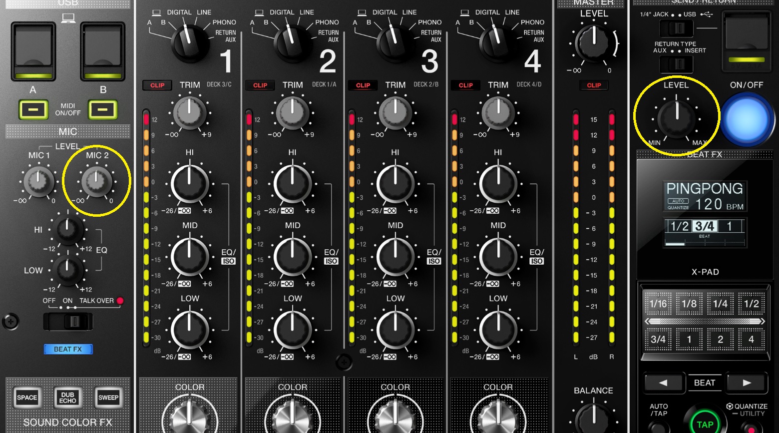

          is there a way to midi map this knob in DJM-900NXS2 and assign it to Sampler Volume Knob in VDJ?
Thanks!
Thanks!
Posted Sun 12 Jan 25 @ 6:14 am
          Since the DJM is a hardware mixer, even if this knob would send midi, it would also still alter the balance, which is probably not what you want.
But since you use the XP2 together with the DJM, don't you have the sampler routed to one of the DJM channels already anyway? (And therefore can just use the level/gain/eq of that channel to adjust the sampler)
Posted Sun 12 Jan 25 @ 6:26 am
Thanks but I dont understand...I think the XP2 doesnt have a mixer channel...
Bear in mind I've just ordered the XP2 and I need to test it against a club setup (2CDJ NXS2 + DJM900NXS2) as soon as it will arrive this week.
I was just trying to prepare myself in order to test all the funcionalities.
I bought the XP2 to manage pads (CUEs, STEMS, EFFECTs, LOOPS etc) when I play in the club and I cant bring my DDJ-1000.
Posted Sun 12 Jan 25 @ 6:37 am
          I suppose currently you use the sampler from the pads then and have them output to the same channel as the pads?
Except for stemswap banks (but then you probably want to keep the deck volume anyway), you can use samplerOutputDeck to have the sampler output to deck 3 or 4, so that you can control the sampler from your mixer.
Posted Sun 12 Jan 25 @ 10:08 am
DDJ-XP2 is misleading in this request... I mean i just need to assign a specific VDJ software action (control the Samples Volume) to a knob of the DJM-900NXS2.
For istance if I connect VDJ to a XDJ-RX2 VDJ automatically assign the Samples Volume to this knob
So I assume I can do the same choosing a DJM-900NXS2 knob which I dont use.
