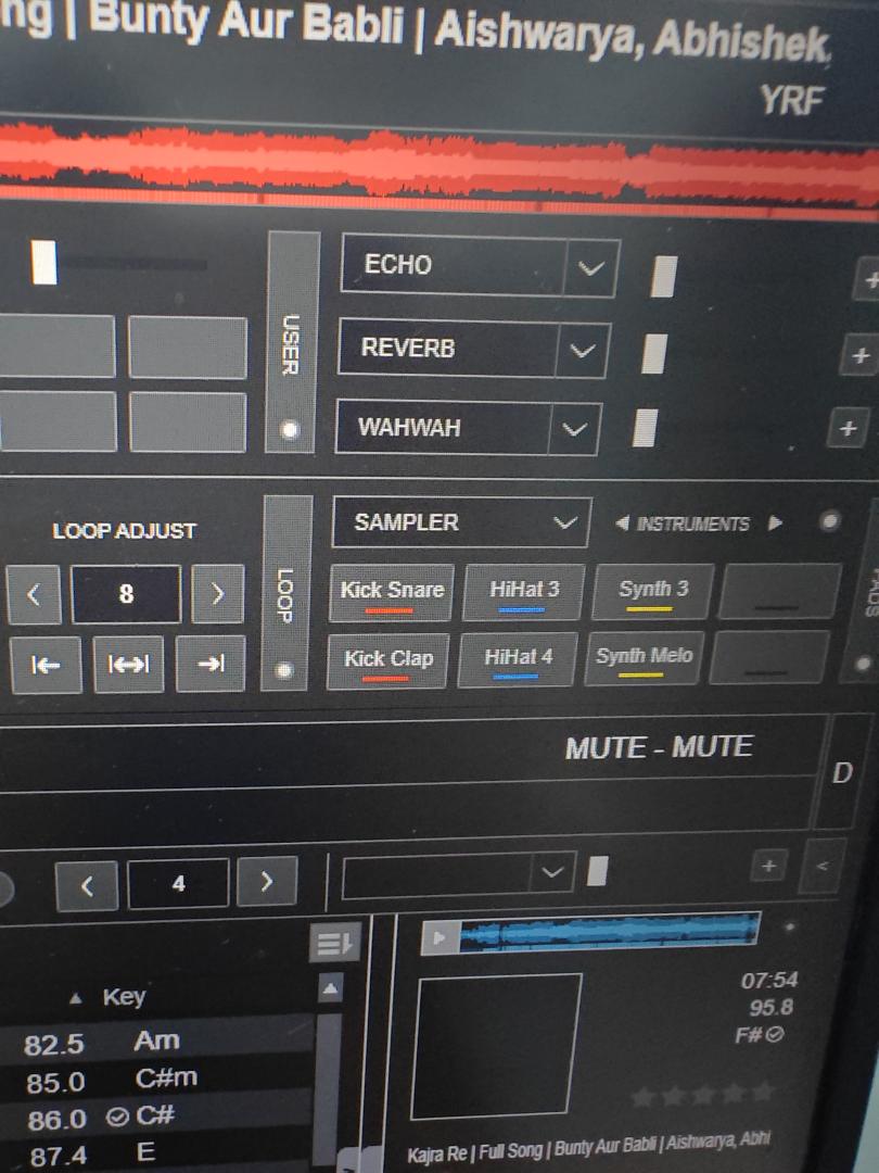

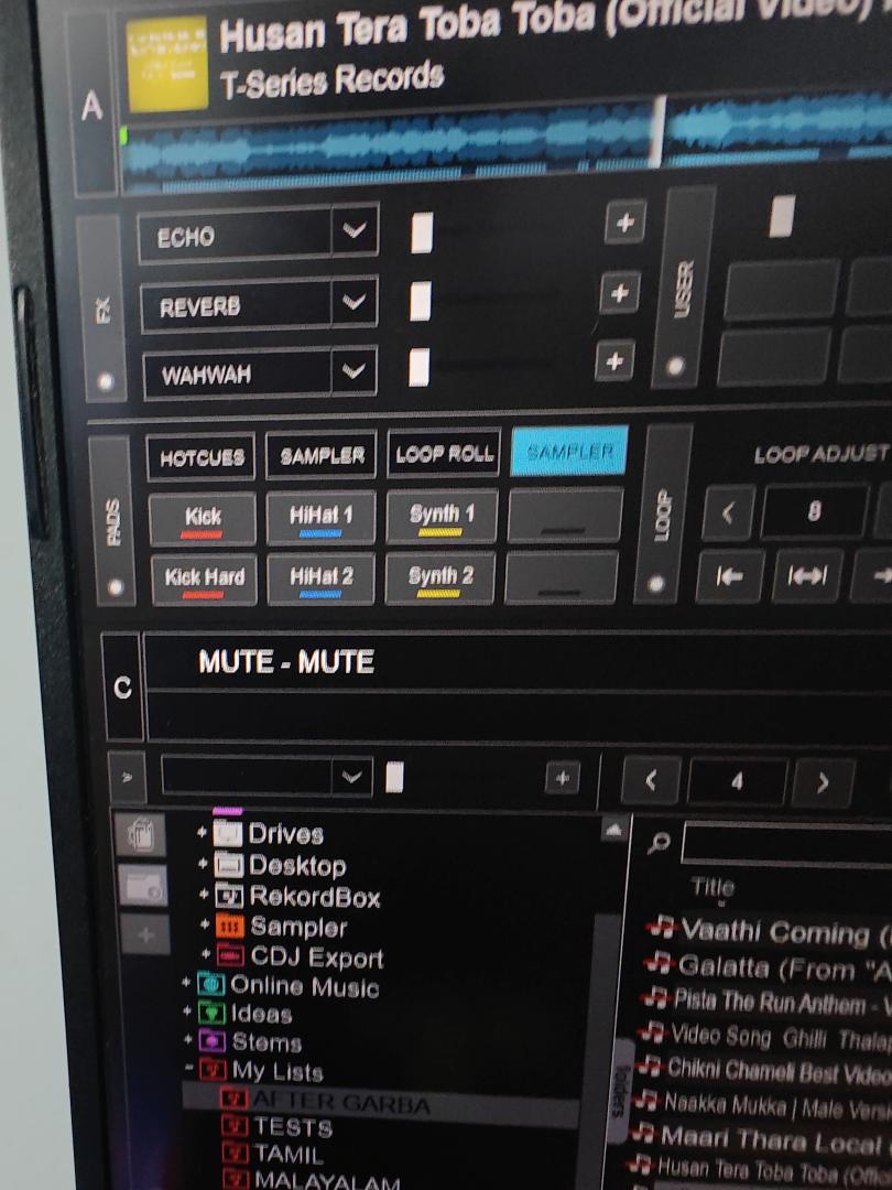

The sampler options differ on my decks for some reason. I just wanted to know how I can change them so it can match. Just to be clear I'm not talking about sampler packs, I'm talking about the samplers on the action pads. So how can I change them to make it match on both the decks ?

If your sample bank is limited to 8 samples then both decks will show the same samples

https://www.virtualdj.com/manuals/virtualdj/interface/browser/sideview/sampler.html
In the browser you can show/create/modify the banks

FYI, this has been changed in the new version that will be released soon, and will now work as you expect.
(this behavior was a leftover from the early sampler days when people used dedicated "16 pads" MIDI controllers to control their sampler. before the first controllers with pad came on the market. Obviously in 2024 most controllers have 8 pads on each decks, hence the upcoming change)
