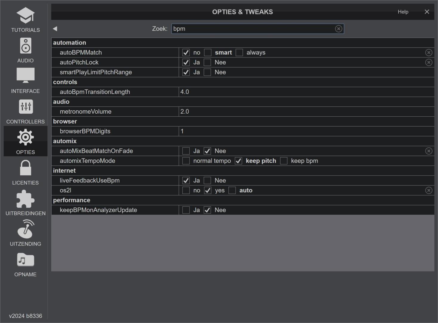

What are your automixTempoMode, autoMixMode and autoMixDualDeck set to?
Posted Tue 08 Oct 24 @ 6:52 am
AutomixDualDexk ="No"
AutomixTempoMode = "keep pitch"
Altho it wasn't doing that, the pitch was moving all over the place, ranging from -8% to +4% just on the few mixes I observed before I stopped automix.

What is happening is the pitch fader is moving as the mix happens, (ie to mix into a 117 Bpm track from a 128 Bpm track the 128 Bpm track needs to be reduced down to -8.5% during the mix) then when the mix stops, rather than resetting the pitch to 0%, it applies -8.5% pitch to the new track, therefore reducing it's speed accordingly.
Technically it is 'keeping pitch' after the mix ends, but the pitch is moving during the mix, is this what was intended because it ends up with some very strange pitching.
Changing automixTempoMode to "normal" restores the automix method I am used to.
