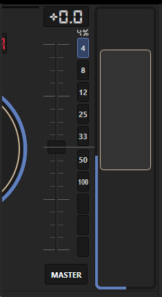

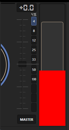

I'm making a skin and want to use a clipmask to hide part of the <visual> to make a VU, but when I use color inside a visual, it doest work.
This code, doesn't work, the clipmask is not aplied
But this works:
I have to put an image in the png to make the clipmask work. I also tried with <mask>, but it doesn't work
<visual source="get_level_left" type="linear" orientation="vertical">
<pos x="+1" y="+0"/>
<size width="88" height="411"/>
<down color="red" />
<clipmask x="438" y="309" />
</visual>
But this works:
<down x="438" y="725"/>
</visual>

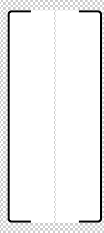

This is how my clipmask is on my png file. it works when I change the code to use a solid blue rectangle in png, but with vector graphics, it doesnt work
and sorry for the tittle of this topic, I put <clipmask> on the tittle but it seems that the forum doesnt allowed.

clip mask indeed only works for images.
Do you actually need the clip mask though?
You could also draw the rounded border on top of the vu?

The skin that I designed has the VU meter around the channel and I want to represent the LEF and RIGHT vu accordingly and want to avoid png graphics, the entire skin is 99% vector based.
