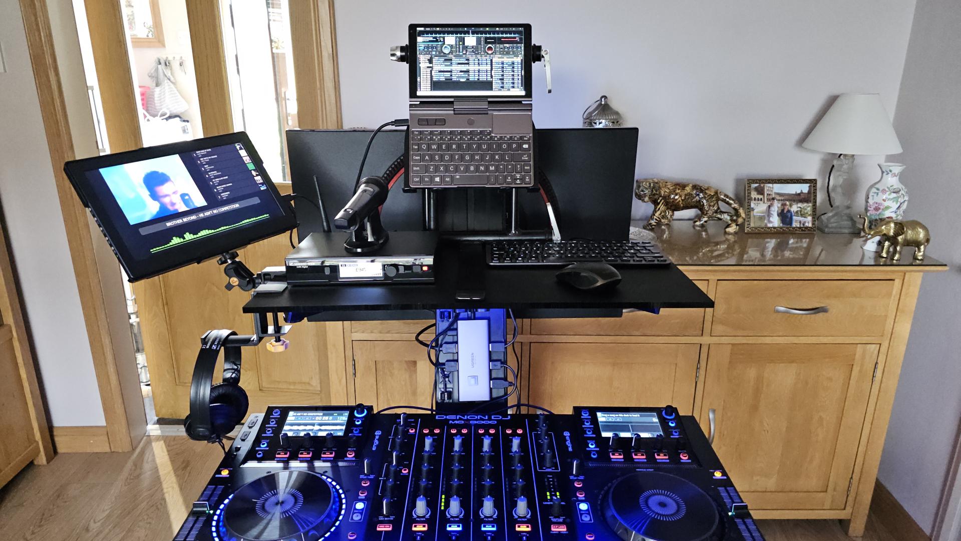

Personally have been using dell xps 15 and recently xps 16 without issues
Posted Mon 05 Aug 24 @ 12:43 pm
Shame they don't so XPS as a 2-in-1 any more.
I've been testing with my GPD pocket 3 today and it has run for over 5 hours with no issues. I used to think it was an issue specifically with Windows 11 but clearly not.
It's running a 11th Gen Core i7 and seems to work fine, where the two recent ones I tested with the current Core Ultra 7 chips just shut the music off with the Denon drivers or glitch with the Pioneer ones.
Something is definitely amiss somewhere.
