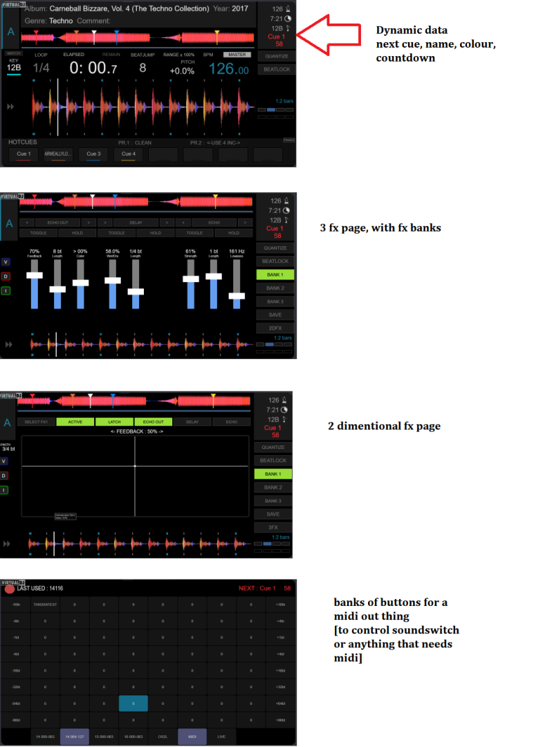

Just a little log of the changes I made to the sc5k skin, it also applies to sc6k [they use the same skin]
The last pic has yet to be tested [I'll know pretty soon]. It's a specialist midi thing for lamping, but it could be easily changed to work as a custom; tagging, fx calls, ... anything type of page
It's a little bit of a shame that vdj is the only software that lets you reskin device screens, because it's literally unlimited buttons and sliders.
Once you can* [or ask me to] add your own stuff to the device screen would you ever really need to upgrade to the mk2?
Maybe you would for some hardware fx, but it becomes a lot more questionable when you have infinite buttons & sliders backed up with vdj script.
