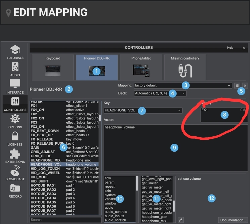

Looking at the video, it would suggest that the fader has a problem but there are things you can try to narrow that down/confirm/eliminate:
- Did you install the latest firmware for the controller (v1.10 it seems at the time of this writing)
- Did you try cleaning the fader with Deoxit or similar?
- If you open the controllers tab, then go to the Missing Controller section, then select you controller and click Edit Mapping, do you see any activity in the upper right box (see the image below):
If you see any activity without pressing/moving anything, then it's definitely a hardware issue. - Do you actually hear audio from the other side if you load and play a song on that deck, with the crossfader fully to the right?
