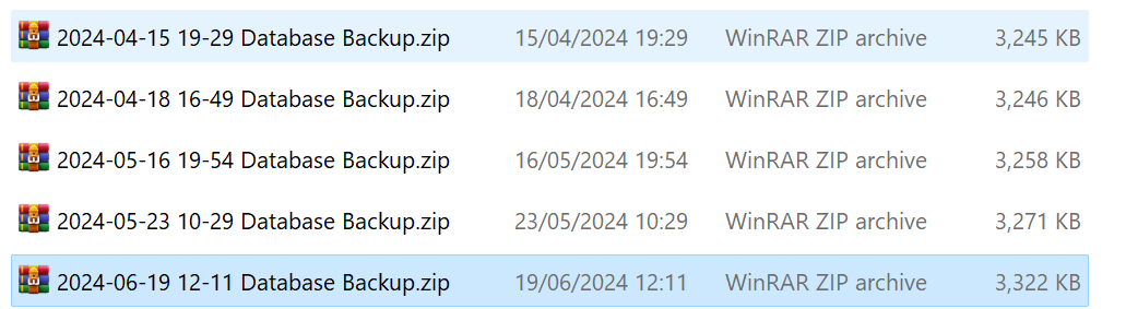

For reference the most recent backup I ran is 3.24mb and it's the same folder I've been using constantly since 2008.

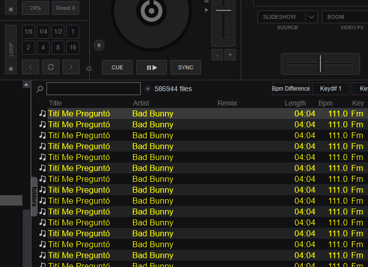

ok, so I got in touch with VDJ tech support, and what i was told was that i have too many lists basically. @600 lists at the moment. apparently these load into memory, unlike history files.
I typed a long post here, but deleted it because I think i have found the real culprit below.
the next thing is to figure out how it is happening.
i have noticed a glitch. see the image below, same song in here 8000 times.
there is no way i dragged this in 8000 times. 3 or 4 times maybe....there was one folder with 132000 entries of the same file.
is there a master option that gets rid of duplictes or does it have to be done folder by folder?

so i have gone through all of the lists and selected "no duplicates"
every list that had dupicates on had way too many duplicates in them for some reason.
some of the lists had over 800,000 duplicates! (it is surprising the computer worked at all !)
the database works well now , it backs up in less than 10 seconds.
the only concern now, is how it happened and how to prevent it from happening in the future, i wonder if other users are having this issue, but may not realise. I didnt realise until it hit the point where the computer couldnt handle it anymore.

Normally 600 lists would not be any problem at all, but indeed with that many duplicates it could have caused slow operation.
I'm not really sure how they would have gotten there though
Posted Wed 26 Jun 24 @ 4:58 am
Never seen that before.
Maybe it was a previous bug that is now fixed. Just keep an eye for the next few weeks to see if your lists have that issue again.
