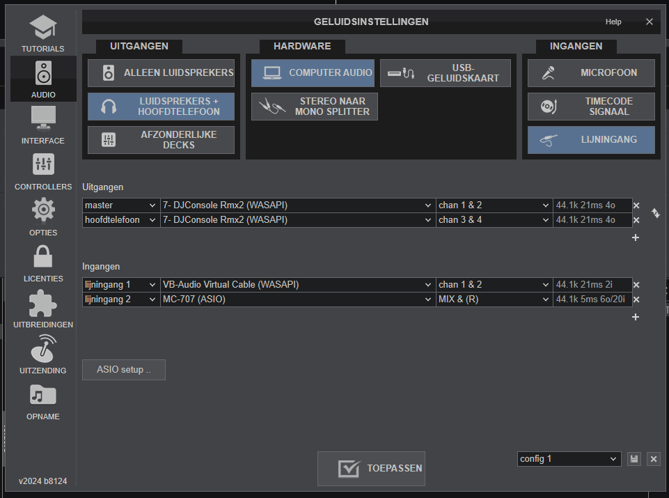

well, thanks dad for the quick reply.
I uninstalled the driver (2023) then opened the exe file as an administrator.
Restarted the laptop and opened up virtual dj.
It has the audio, but no midi, so no control

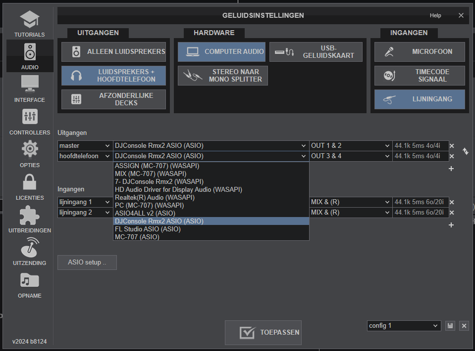

Edit, i just saw your latest screenshots. Windows see the sound card and use the WASAPI native driver, but if the Hercules Driver was properly installed, you should see the Hercules RMX2 ASIO driver.

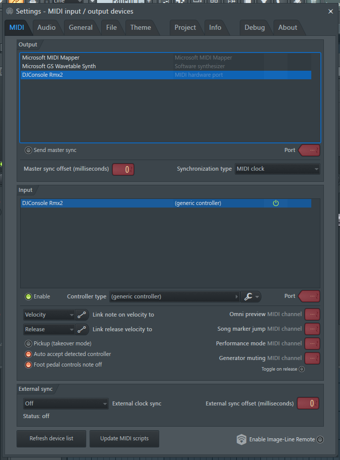

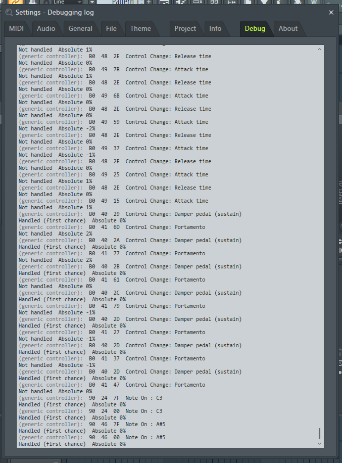

the rm2 workes just fine as a midi controler in fl studio
Posted Fri 10 May 24 @ 6:20 pm

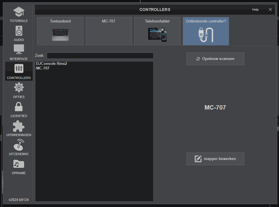

I tried an other cable, other port, still great audio, great fl studio, no controllerfun in virtual dj

I deleted the program and reinstalled it,
works for now
