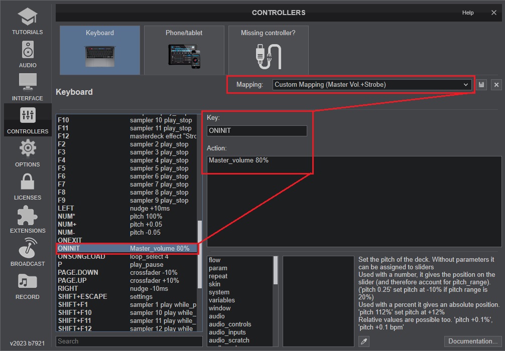

Why not lower your output more like this?
Posted Mon 11 Mar 24 @ 9:44 pm
It will not work.
As I said above, Rane FOUR has a hardware (external) mixer audio setup.
This means there's no "master" channel on the audio setup, and you can't control "master" if it does not exist.
Also, since I personally used Rane FOUR on my own gigs a few times, I also find it strange that someone would need more than 12db headroom.
I usually run it at -6 or -9db
Yes, if you overdo it, FOUR will distort the sound and will also output that distortion on master.
However, if you're sensible with what you're doing, you should be fine, far away from that point.
