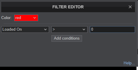

One more question. In my old software as soon as a song was loaded it turned red. How can I set that up?

set up a color rule, [quick filter button, on the search bar]
Already Played = 1
Already Played = 1
Posted Thu 22 Feb 24 @ 4:16 am
That's what I have set up but it's version of Already Played refers to whether it triggers the History button
As I tried that before.

Posted Thu 22 Feb 24 @ 2:31 pm
Thank you that worked
