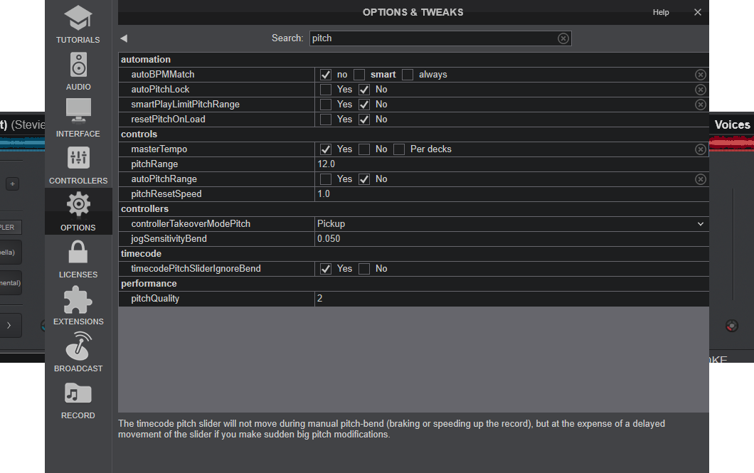

Hi, Kinda new to virtual dj and I run quite large nights that have just started doing some Karaoke.  The problem I have is no matter what settings I play around with, VDJ will always set the auto pitch.  That's not good for Karaoke.  I don't want VDJ to do anything to my pitch other than translate what I do on  my controller pitch faders....
Help me stop VDJ hijacking my sets!!
Included a pic of my auto pitch settings and what I'm talking about.... I'm flummoxed....
Searched to find a solution but everything seems to be how to make it work rather than how to make it stop.

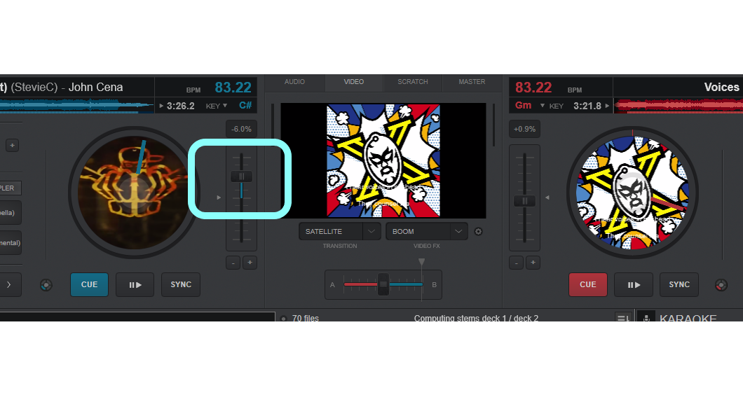

Image one blue rectangle over what VDJ does to my pitch faders....

          Setting everything to "No" without reading what the setting actually does, won't help you.
For instance "smartPlayLimitPitchRange" should probably be set to yes (for 99 out of 100 users)
Also there are other "auto" options that you may want to disable.
And as Locodog said above, you should also disable smart_play
