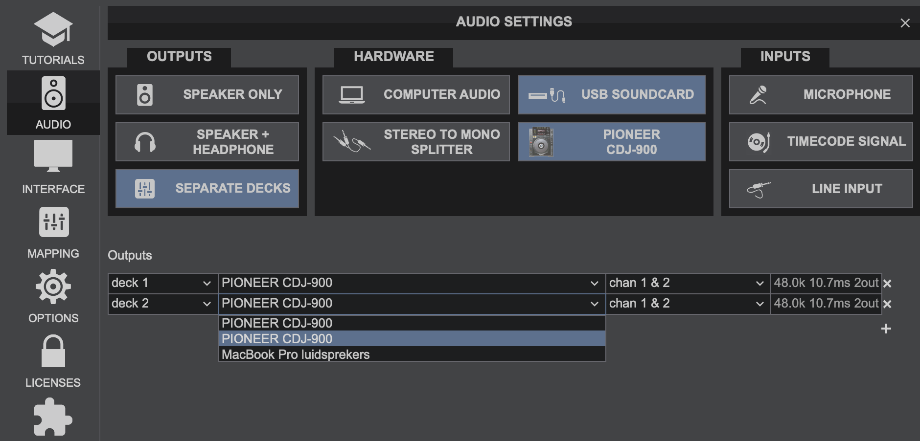

DJ DAD, thanks for your response. The issue occurs on both decks. When playing on only one deck, the sound is perfect. When I use separate decks (deck 1 going to cdj 1, deck 2 going to cdj 2), the second deck I add gives me bad sound quality.
As a mixer, I'm using a DJM-900 NXS, with indeed has a USB interface. However, I would prefer not to use these because I would not have enough USB ports.
Here is te configuration I use:
