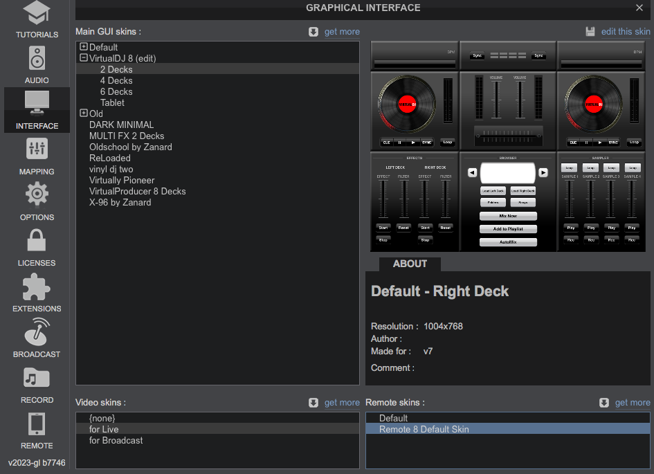

the issue seems to be related to which skin is selected for the remote....
I use the Virtual DJ 8 default main skin with 2 decks selected and with the "Defaul" remote skin set weird things happen as described previously.
If Install and select the "Remote 8 Default skin" I get back the original controls and things seem to calm down - not tried it in class but in testing it seems OK.

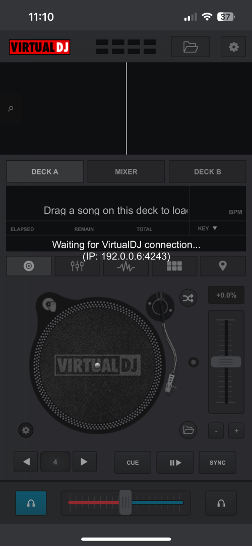

Yup. The iOS app is kind of a mess. Right now, all I get is "Waiting for VirtualDJ connection (IP 192.0.0.64243).... except as far as I know this is not an IP address in use anywhere.
And yes, both my phone and the computer running VDJ are on the exact same network...

So even manually entering this ip address in vdj doesn't work?
Posted Fri 19 Jan 24 @ 9:33 am
can't access settings... The app is "stuck" here. I've deleted it, and re-installed it, but I end up at the same place all the time.... looking for VDJ on an IP address on a network I can't connect to.....
Posted Fri 19 Jan 24 @ 3:15 pm
So while I CAN enter that IP in the computer running VDJ, it will basically take it off the network that the iPhone is on, so they still won't be able to "see" each other. Also, I can't construct a computer network that includes the IP address that the phone app is looking for. My router will only allow the address range to be 192.168.x.x, so can't make it 192.0.x.x which is what the phone app is looking for....
Posted Sat 20 Jan 24 @ 5:24 pm
I believe the remote uses Bonjour which does networking a bit differently over al LAN/Wi-Fi network.
Posted Sun 21 Jan 24 @ 12:57 am
could be but still can't get to the preferences to change anything, so for the moment, its useless...
Posted Wed 24 Jan 24 @ 11:14 pm
