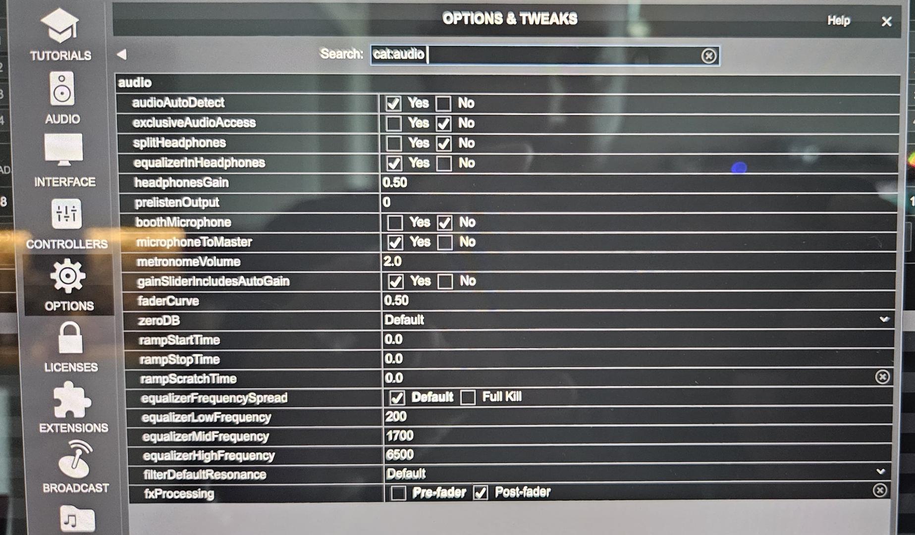

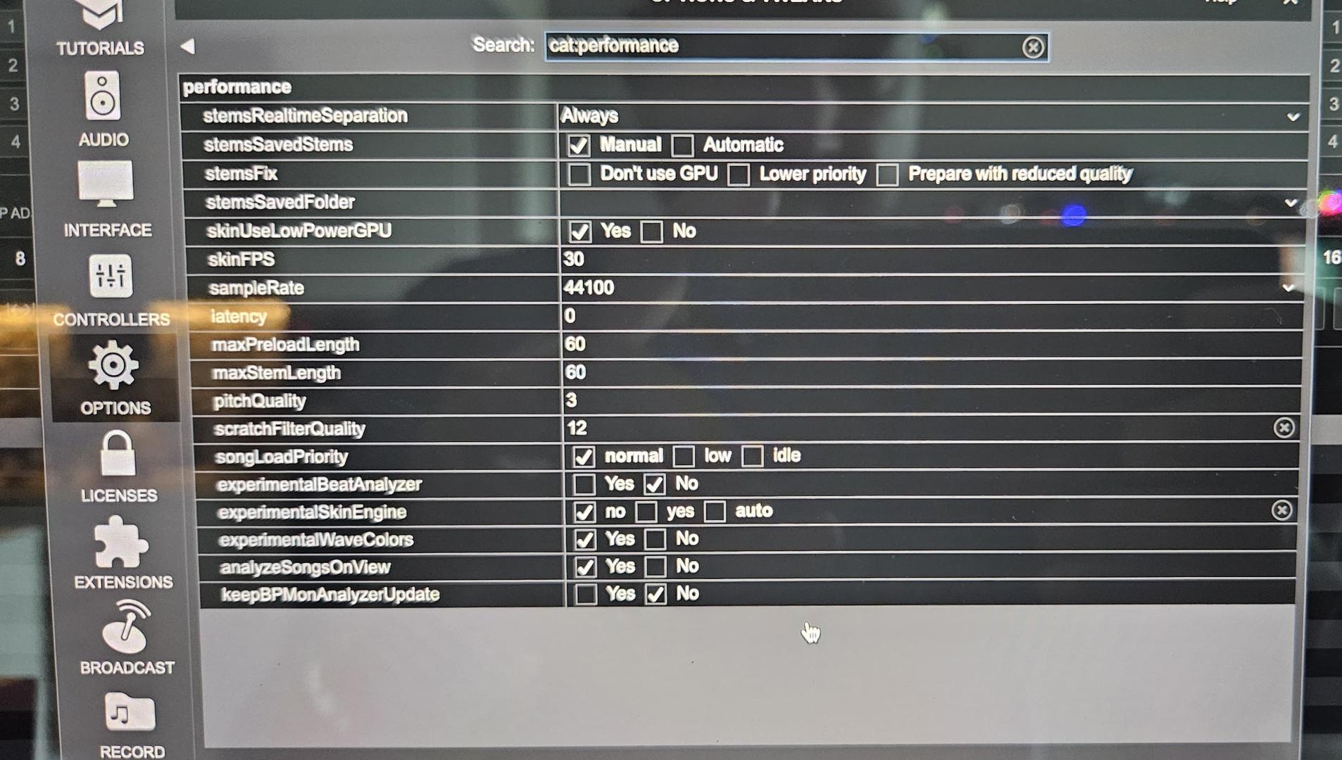

AudioDelite wrote :
https://www.youtube.com/watch?v=LhW5qM1nmMY
AudioDelite can you please post a pic of your VDJ audio settings and performance options?
Posted Thu 04 Jul 24 @ 6:35 pm
Posted Fri 05 Jul 24 @ 8:55 am
