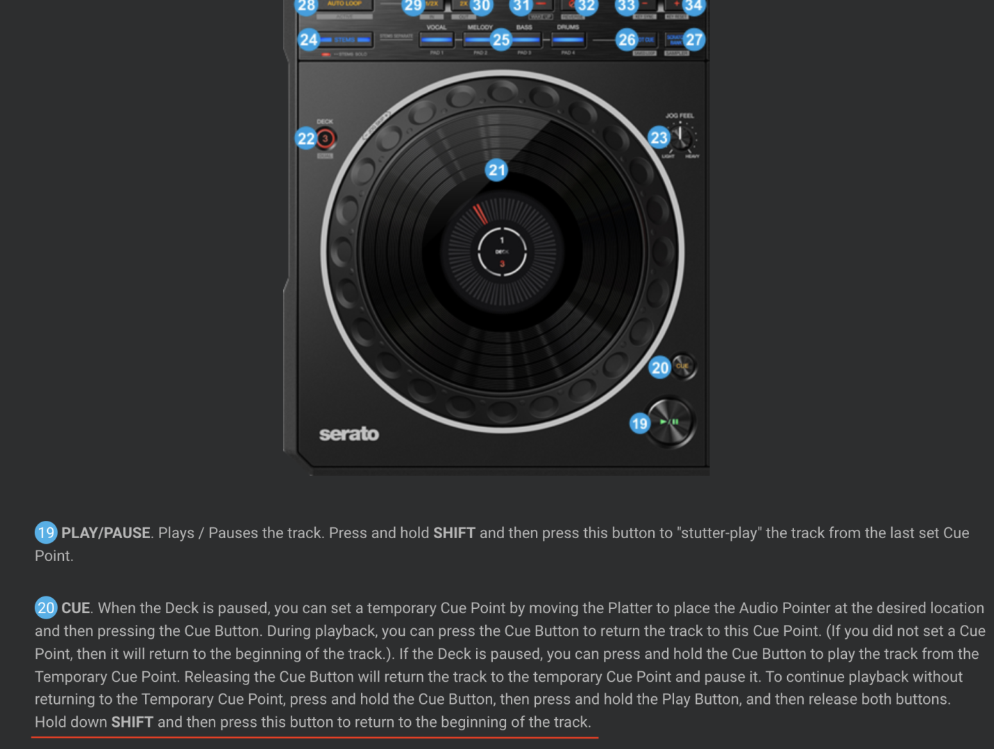

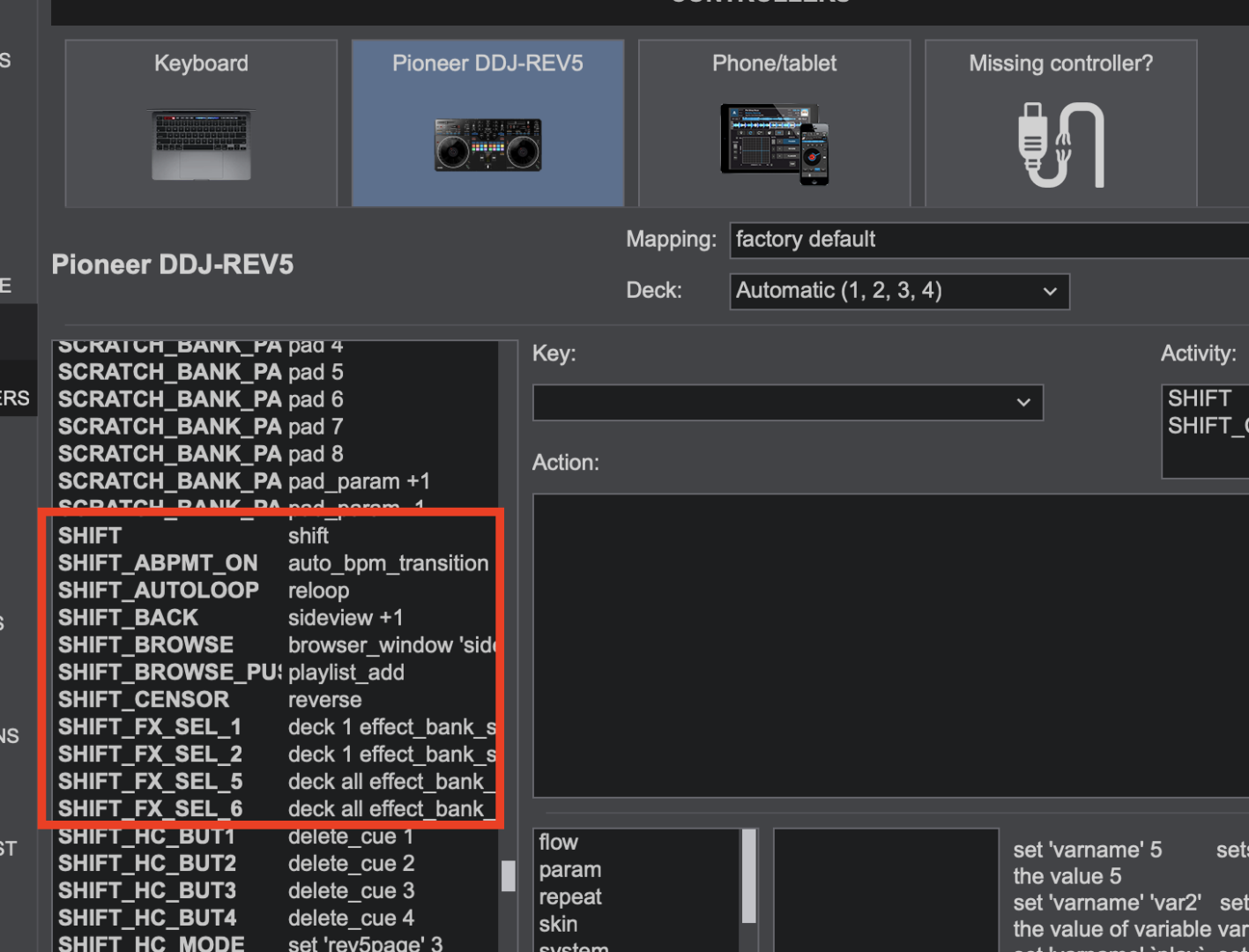

I don't mean to hijack this post but i believe the issue i'm bringing would fit under this topic.
The shift+cue button usually brings the track back to the beginning in every controller i've owned prior to this rev5 and the site says that this is supposed to happen in the mappings (see pic), but it doesn't work when i try it. In fact there's no shift+cue (SHIFT_CUE) function in the mappings as well.
I believe i can map it myself but i also do believe this i an error based on the info found on the site for rev5
