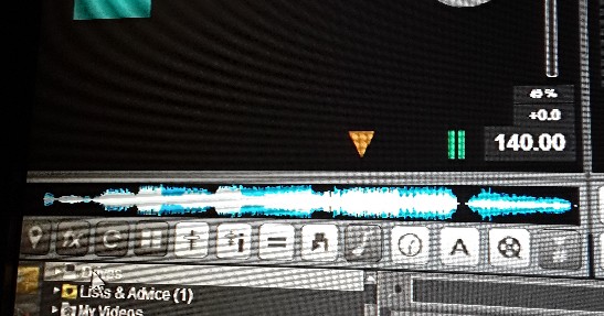

Heres something I forgot,
On focus when I set a cue point there is no marker line added to the waveform
Is that feature in the skin or vdj settings?

Locodog,Normally when I set a start song cue point a little vertical line is placed on that songs waveform,
As you see in the pic no marker line, it will go back to the place I set it but I like to see it there like my old skin did.
Posted Wed 25 Oct 23 @ 10:37 pm
take actual screenshots, phone camera photographs of a screen are embarrassing.
how to screenshot
old cue_button must have set hotcue 1, with v8 onwards cue_button is temporary but is marked in the scratch/rhythm (the top) wave. But the old behaviour could be wrote in.
how to screenshot
