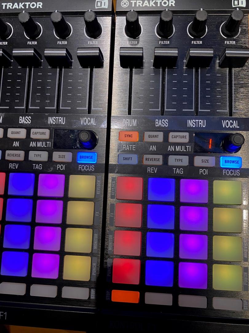

I do have four F1's (one per deck) that I mapped and use exclusively for Stems (with Stems padfx Echo out at the bottom of each row). Might not be the best "code-wise" way to do some of these functions, but everything works as I want so I'm good with that. Feel free to grab ideas from it ;-)
<mapper device="TRAKTORF1" author="BeatAddict" version="850" date="2023-06-29">
<info>https://virtualdj.com/manuals/hardware/ni/f1.html</info>
<map value="FILTER1" action="nothing"/>
<map value="FILTER2" action="nothing"/>
<map value="FILTER3" action="nothing"/>
<map value="FILTER4" action="nothing"/>
<map value="SYNC" action="loaded_song 'rating' 0 ? loaded_song 'rating' 1 : loaded_song 'rating' 1 ? loaded_song 'rating' 2 : loaded_song 'rating' 2 ? loaded_song 'rating' 3 : loaded_song 'rating' 3 ? loaded_song 'rating' 4 : loaded_song 'rating' 4 ? loaded_song 'rating' 5 : loaded_song 'rating' 0"/>
<map value="QUANT" action="reanalyze"/>
<map value="CAPTURE" action="reanalyze multi"/>
<map value="SHIFT" action="shift"/>
<map value="REVERSE" action="slip_mode ? dump while_pressed : reverse"/>
<map value="TYPE" action="file_info"/>
<map value="SIZE" action="edit_poi"/>
<map value="BROWSE" action="browser_window 'folders,songs'"/>
<map value="PARAM" action="browser_scroll"/>
<map value="PARAM_PUSH" action="browser_enter & lock_cues on & stem "rhythm" 50% & stem "bass" 50% & stem "instru" 50% & stem "vocal" 50% & effect_active 1 0 & effect_active 2 0 & effect_active 3 0 & effect_active 4 1 & loop off"/>
<map value="PAD1" action="stem "rhythm" 50%"/>
<map value="PAD5" action="stem "rhythm" 30%"/>
<map value="PAD9" action="stem "rhythm" 15%"/>
<map value="PAD13" action="stem "rhythm" 0%"/>
<map value="PAD2" action="stem "Bass" 50%"/>
<map value="PAD6" action="stem "Bass" 30%"/>
<map value="PAD10" action="stem "Bass" 15%"/>
<map value="PAD14" action="stem "Bass" 0%"/>
<map value="PAD3" action="stem "Instru" 50%"/>
<map value="PAD7" action="stem "Instru" 30%"/>
<map value="PAD11" action="stem "Instru" 15%"/>
<map value="PAD15" action="stem "Instru" 0%"/>
<map value="PAD4" action="stem "Vocal" 50%"/>
<map value="PAD8" action="stem "Vocal" 30%"/>
<map value="PAD12" action="stem "Vocal" 15%"/>
<map value="PAD16" action="stem "Vocal" 0%"/>
<map value="STOP1" action="padfx "echo out" 60% 1bt "stemfx:Rhythm""/>
<map value="STOP2" action="padfx "echo out" 50% 1bt "stemfx:Bass""/>
<map value="STOP3" action="padfx "echo out" 80% 1bt "stemfx:Instru""/>
<map value="STOP4" action="padfx "echo out" 80% 1bt "stemfx:Vocal""/>
<map value="VOLUME1" action="param_multiply 0.5 & stem "rhythm""/>
<map value="VOLUME2" action="param_multiply 0.5 & stem "bass""/>
<map value="VOLUME3" action="param_multiply 0.5 & stem "instru""/>
<map value="VOLUME4" action="param_multiply 0.5 & stem "vocal""/>
<map value="LCD_DISPLAY" action="get_beat_num"/>
<map value="LED_SYNC" action="get_beat"/>
<map value="LED_QUANT" action="off"/>
<map value="LED_CAPTURE" action="off"/>
<map value="LED_SHIFT" action="shift"/>
<map value="LED_REVERSE" action="reverse"/>
<map value="LED_TYPE" action="off"/>
<map value="LED_SIZE" action="off"/>
<map value="LED_BROWSE" action="on"/>
<map value="LED_PAD1" action="padfx "echo out" 60% 1bt "stemfx:rhythm" ? blink 1bt 90% ? color 'red' :color 'black' : play ? stem "rhythm" & param_bigger 49% ? blink 1bt 5% ? color 'white': color 'darkred' : color 'black' : stem "rhythm" & param_bigger 49% ? color 'darkred'"/>
<map value="LED_PAD5" action="padfx "echo out" 60% 1bt "stemfx:rhythm" ? blink 1bt 90% ? color 'red' :color 'black' : stem "rhythm" & param_bigger 29% ? color 'darkred'"/>
<map value="LED_PAD9" action="padfx "echo out" 60% 1bt "stemfx:rhythm" ? blink 1bt 90% ? color 'red' :color 'black' : stem "rhythm" & param_bigger 14% ? color 'darkred'"/>
<map value="LED_PAD13" action="padfx "echo out" 60% 1bt "stemfx:rhythm" ? blink 1bt 90% ? color 'red' :color 'black' : stem "rhythm" & param_bigger 0% ? color 'darkred'"/>
<map value="LED_PAD2" action="padfx "echo out" 50% 1bt "stemfx:Bass" ? blink 1bt 90% ? color 'red' :color 'black' : play ? stem "Bass" & param_bigger 49% ? blink 1bt 5% ? color 'white': color 'darkblue' : color 'black' : stem "Bass" & param_bigger 49% ? color 'darkblue'"/>
<map value="LED_PAD6" action="padfx "echo out" 50% 1bt "stemfx:Bass" ? blink 1bt 90% ? color 'red' :color 'black' : stem "Bass" & param_bigger 29% ? color 'darkblue'"/>
<map value="LED_PAD10" action="padfx "echo out" 50% 1bt "stemfx:Bass" ? blink 1bt 90% ? color 'red' :color 'black' : stem "Bass" & param_bigger 14% ? color 'darkblue'"/>
<map value="LED_PAD14" action="padfx "echo out" 50% 1bt "stemfx:Bass" ? blink 1bt 90% ? color 'red' :color 'black' : stem "Bass" & param_bigger 0% ? color 'darkblue'"/>
<map value="LED_PAD3" action="padfx "echo out" 80% 1bt "stemfx:Instru" ? blink 1bt 90% ? color 'red' :color 'black' : play ? stem "Instru" & param_bigger 49% ? blink 1bt 5% ? color 'white': color 'darkmagenta' : color 'black' : stem "Instru" & param_bigger 49% ? color 'darkmagenta'"/>
<map value="LED_PAD7" action="padfx "echo out" 80% 1bt "stemfx:Instru" ? blink 1bt 90% ? color 'red' :color 'black' : stem "Instru" & param_bigger 29% ? color 'darkmagenta'"/>
<map value="LED_PAD11" action="padfx "echo out" 80% 1bt "stemfx:Instru" ? blink 1bt 90% ? color 'red' :color 'black' : stem "Instru" & param_bigger 14% ? color 'darkmagenta'"/>
<map value="LED_PAD15" action="padfx "echo out" 80% 1bt "stemfx:Instru" ? blink 1bt 90% ? color 'red' :color 'black' : stem "Instru" & param_bigger 0% ? color 'darkmagenta'"/>
<map value="LED_PAD4" action="padfx "echo out" 80% 1bt "stemfx:Vocal" ? blink 1bt 90% ? color 'red' :color 'black' : play ? stem "Vocal" & param_bigger 49% ? blink 1bt 5% ? color 'white': color 'darkyellow' : color 'black' : stem "Vocal" & param_bigger 49% ? color 'darkyellow'"/>
<map value="LED_PAD8" action="padfx "echo out" 80% 1bt "stemfx:Vocal" ? blink 1bt 90% ? color 'red' :color 'black' : stem "Vocal" & param_bigger 29% ? color 'darkyellow'"/>
<map value="LED_PAD12" action="padfx "echo out" 80% 1bt "stemfx:Vocal" ? blink 1bt 90% ? color 'red' :color 'black' : stem "Vocal" & param_bigger 14% ? color 'darkyellow'"/>
<map value="LED_PAD16" action="padfx "echo out" 80% 1bt "stemfx:Vocal" ? blink 1bt 90% ? color 'red' :color 'black' : stem "Vocal" & param_bigger 0% ? color 'darkyellow'"/>
<map value="LED_STOP1" action="padfx "echo out" 60% 1bt "stemfx:rhythm" ? padfx "echo out" 60% 1bt "stemfx:rhythm" : get_beat_num 1"/>
<map value="LED_STOP2" action="padfx "echo out" 50% 1bt "stemfx:bass" ? padfx "echo out" 50% 1bt "stemfx:bass" : get_beat_num 2"/>
<map value="LED_STOP3" action="padfx "echo out" 80% 1bt "stemfx:Instru" ? padfx "echo out" 80% 1bt "stemfx:Instru" : get_beat_num 3"/>
<map value="LED_STOP4" action="padfx "echo out" 80% 1bt "stemfx:vocal" ? padfx "echo out" 80% 1bt "stemfx:vocal" : get_beat_num 4"/>
<map value="SHIFT_TYPE" action="loaded_song 'comment' "NightClubDJ""/>
</mapper>
