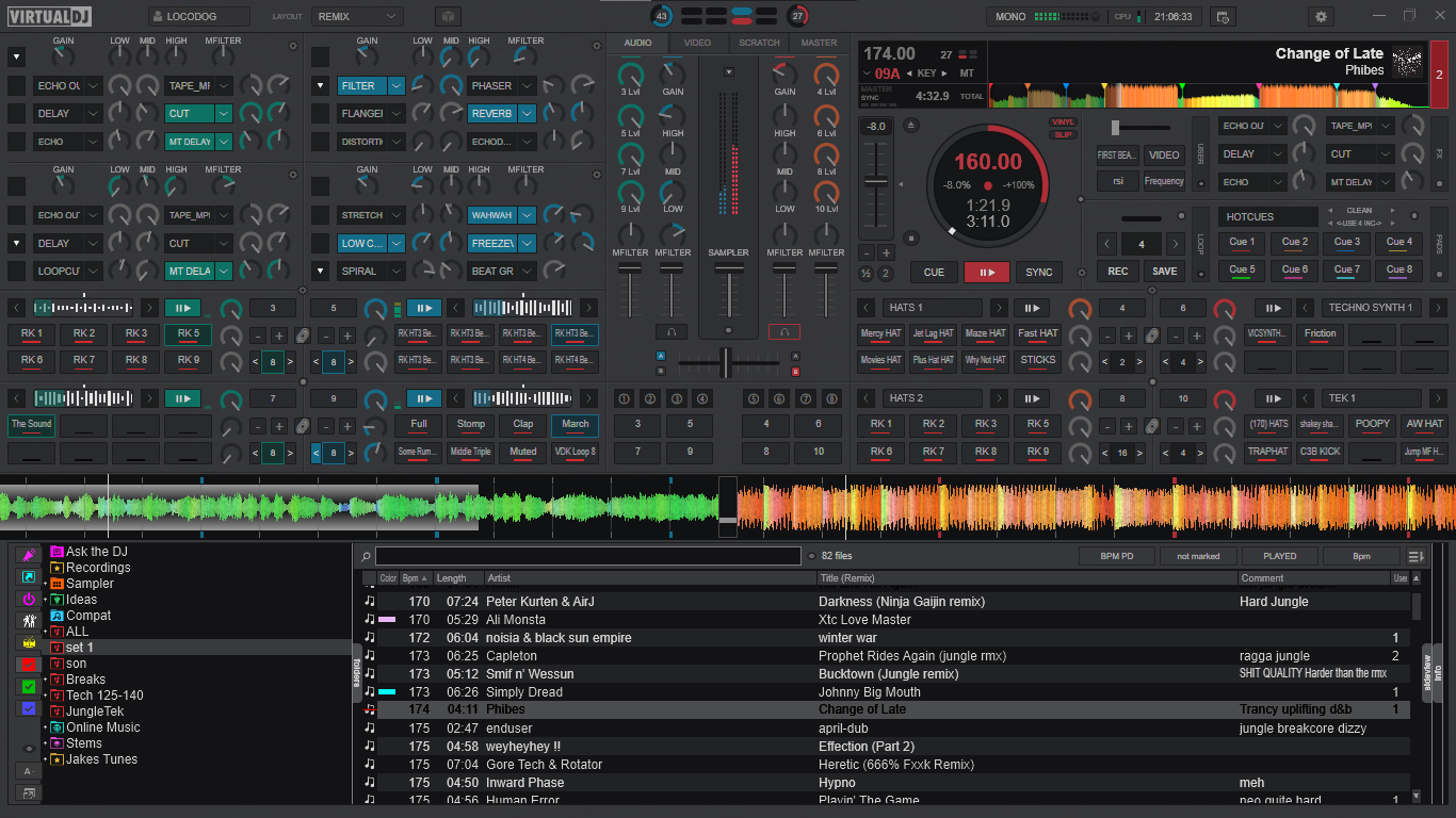

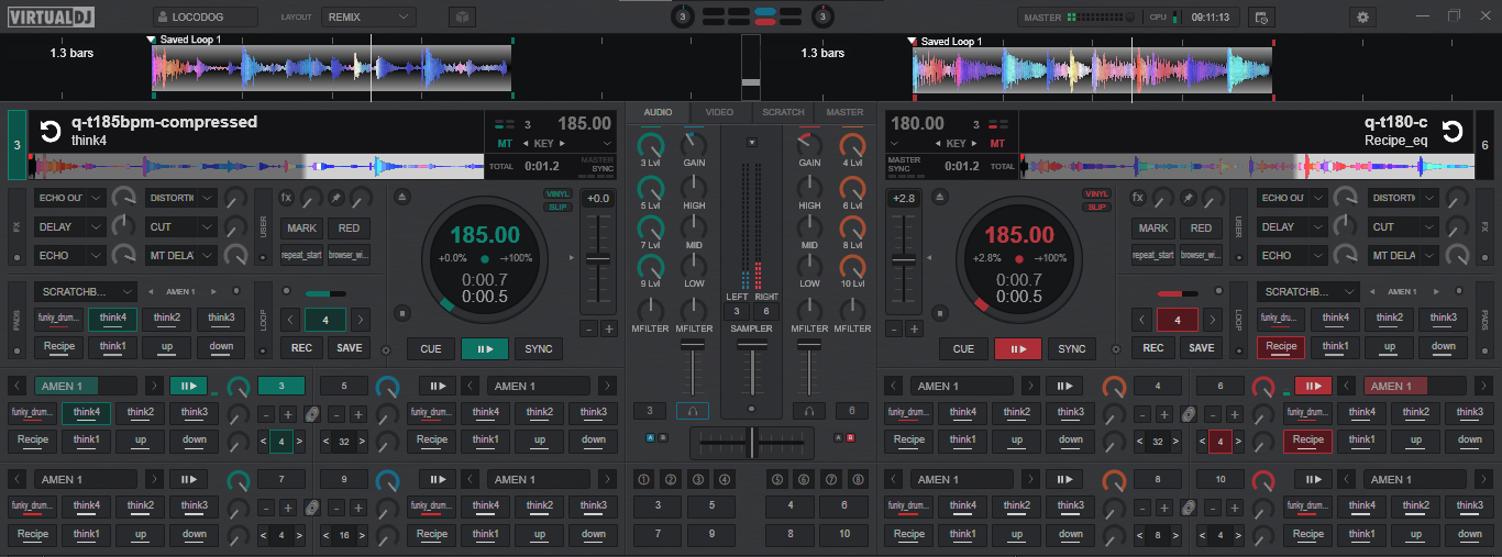

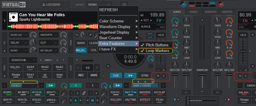

First we have the top options, nothing too fancy there, but there's a "no waves" option to save some space.
Image 2 should mostly explain itself but I get into details in a minute.
Finally the mixer should explain itself.
for the color fx what you see is colorfx for deck 3/4, what you control is all decks
similar for colorfx select, you're picking deck 3/4 behind the scenes if you swap the other decks of this side swap too.
The bypass button area is a space for future development.

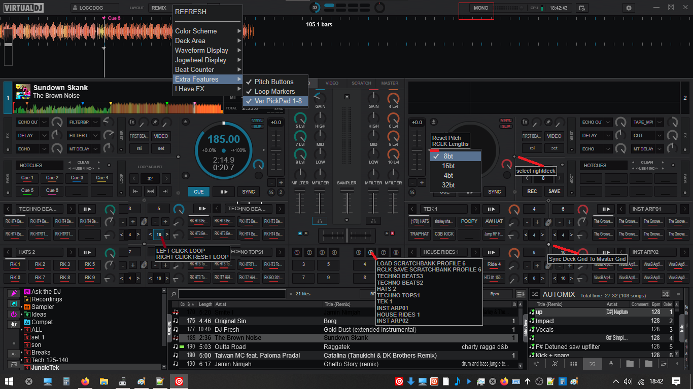

Big question, when you press a pad WHEN does it start?
It depends... you press a pad it goes thru a list of decisions,
Is my deck playing?
__ Am I in a loop ?
____When I start playing depends on where I am in loop & loopsize :
____ not in a loop, I start playing on the 1 of a 32 beat cycle
__ My deck is not playing, is any deck playing ?
____ Yes a deck is playing [masterdeck] - do similar loop queries
____ No nothing is playing - play right away
So when does it actually play?
loops upto and including 1 it plays on the new beat
2 loop, it starts playing on the 1 of 2
4 loop, it starts playing on the 1 of 4
8 loop plays on the 1 or the 5 whichever first
16 loop plays on the 1, 5, 9, 13, whichever first
32 loop plays on the 1, 9, 17, 25 whichever first
loop 64 I think it plays only on the 1 of 32
[so awkward saying the 9 of 32, it's 25% point of the loop]

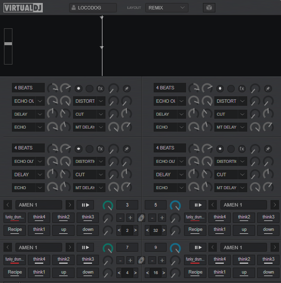

Extra, the LINK button, the link button will delay the "my deck wants to change" message until both decks have something to send.
Only decks a side to each other link, 3&5, 4&6, 7&9, 8&10
When pressing there is no tolerance for pressing late, you might get away with ~50ms late, which is nothing, always aim for pressing early and the mechanism will deal with it.
[unless you're in a 16th loop then it's all on you]

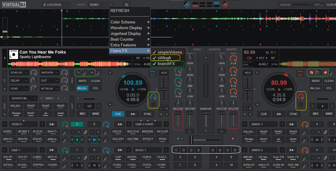

          3200 in 9 days, wow, free skins just move quicker than free fx I guess.
This hasn't been submitted yet, is subject to change, I'm waiting for something before I submit, but it's slow posting today;
works in progress
red, extra pitch buttons for fun
yellow, loop change markers to hold your hand until you don't need the training wheels any more
now bonus features if you have some of my plugins [sorry mac users]
red, simpleVolume means we can have up faders for decks 3,5,7,9 combined [and 4,6,8,10 for their side] If mac users have a reliable volume vst, AU, thing, let me know I could make accommodations.
yellow, sWingIt, kind of mental running it at full speed but it kind of works, fixed at 2* the dial is the needle position
green, branchFX I had to get this in somewhere, button to turn it on is the "fx" button. The "Pin" button to make a branch
white, save & recall loaded scratch banks
not shown,
updated most of the tooltips
loop size/move buttons will now flash if end/start of loop exceeds the track
shown but not marked, loop buttons, record loop for ripping & save loop all accessible from 1 panel [save will save and open poi editor so you can make the loop automatic]

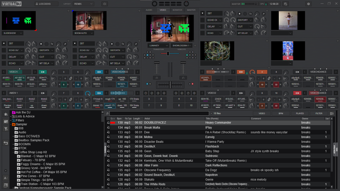

          https://raveforgeaudio.com/products/iron-forge-hard-techno-arsenal
Sooo much fun, I just lost 3 hours playing blind.
Everything is 150 bpm [except 1 shots, I'll have to figure something for 1 shots] and not as bang bang bang as the "hard techno" label suggests [even though I'm cranking house tech-house @+20% on A&&B to put a bit of soul back into it]
I'm not going to hear a bad word about vdj's fx, if you think that, you're just not using them right, I had a great time.
loads of sweet synth loops , hat loops
just the painful process of prepping it all now and banking them in a way that makes sense.
I think the skin on site is behind my version, but I'm going to add some stuff this week, dropzones on remix decks seems vital after playing blind, have a further go at the video side of it, maybe floating browser, sort out a couple of annoyances that seemed a good idea at the time,

    Video got some love. [maybe deeper than most would use vdj for video, but I have a use for it]
I'm happy with the fx panels now. Filled a bit of space that didn't look good if you don't have branchfx/tape_mprv.

A little pic of some things included.
[the little white markers under the remix deck pads are something I use for encoder based selection pad.] not really necessary to be visible via an option, the option is just there to inform you it's there.
Each remix deck has a variable named var pickpad and a number 1-8 makes a visible mark on the skin. If you get into mapping for this skin you should get it.
The reset pitch lengths has some pretty crazy maths behind it, it resets to neutral pitch in time with the music, for a 8 bt reset as the 8th beat plays and the 9th hasn't started yet, the reset just finishes in time.
One cool thing I just managed to sneak in last second before approval is the deck master bandpass filter, quite a bit of work for something so small but pretty cool results from only 2 dials, and can cover a multitude of sins with a quick tweak.
[actually made out of the hpf & lpf effects, getting 3 dials worth of info represented on one dial was pretty challenging ]
There's probably more in this that's different to the previous release that I've forgot as I've been sat on some changes for months so I forget where the old one left off.
Have fun and be careful, if you get into it, hours just vanish, a huge problem for me has been since it's been functional, any skin work and a little follow up testing turned into a hours long play session, the damn thing is addictive.
