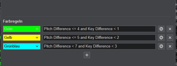

          Here is an example of color filters. does it make sense?
Your color filters are good, in that priorities and ordering are good.
maybe a typo on 3rd BPM difference <8 ...... NEEDS SPACE I believe before the 8
I love the the "Pitch difference" .. (my new go to) and would use that, NOT "BPM difference".(unless that is what you wish)
As mentioned "Pitch difference" will filter ALSO for multiples of the loaded tracks BPM, AND keep the percentage difference the same, when locating those additional tracks. (keeping the Pitch difference the same for all the multiples)
"BPM difference" will NOT find tracks with multiple BPMs
